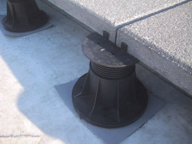

John Kogel Posted May 24, 2014 Report Posted May 24, 2014 The deck is actually a roof. The roof she has a chimney and the chimney she has a smoky old woodstove dripping creosote all over the place. The deck cover is torched-on mod bit with a light granular topping. What is a reasonable way to wash the roof so it looks a bit better without damaging the roofing? I have suggested strongly that they lay down a walking surface, which will also cover up the stain. Any ideas? Click to Enlarge 29.22 KB Click to Enlarge 70.57 KB
Jim Katen Posted May 24, 2014 Report Posted May 24, 2014 They shouldn't be walking on that surface anyway. I'd suggest duckboards or something similar. They make some nice looking tile systems that work well over mod bit membranes.
John Kogel Posted May 25, 2014 Author Report Posted May 25, 2014 Is there a solvent or cleaner that won't damage the roofing?

Jim Katen Posted November 21, 2014 Report Posted November 21, 2014 Click to Enlarge 47.32 KB Click to Enlarge 41.86 KB
Chad Fabry Posted November 21, 2014 Report Posted November 21, 2014 Katen's solution is spot on, if not the proprietary system then a series of sleepers and decking. To answer the question though, the best product I've ever used for creosote removal is Spray Nine. It is the best general purpose cleaner I've ever used. It makes Simple Green and 409 seem like they're just water.
