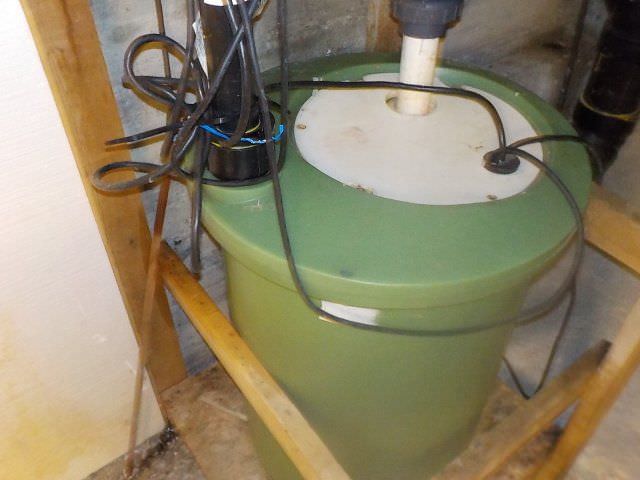

John Kogel Posted October 18, 2014 Report Share Posted October 18, 2014 Ejector pump tank size? How big should the poop tank be for 4 full bathroms, 3500 Sq ft with a suite? The lid was loose, so i had to check out the piggy-back float valves. Viewer discretion is advised. [] Click to Enlarge 44.26 KB Click to Enlarge 71.77 KB Quote Link to comment Share on other sites More sharing options...
Bill Kibbel Posted October 19, 2014 Report Share Posted October 19, 2014 First you have to determine the needed GPM of the pump, based on fixture units plus the total head. Then, refer to the pump manufacturer's chart for the correct size basin for proper pump frequency. Quote Link to comment Share on other sites More sharing options...
John Kogel Posted October 19, 2014 Author Report Share Posted October 19, 2014 First you have to determine the needed GPM of the pump, based on fixture units plus the total head. Then, refer to the pump manufacturer's chart for the correct size basin for proper pump frequency. Since I forgot my snorkel and face mask, [:-party] I'm am going to try and determine from the pic if that is a 1/3 Hp or 1/2 Hp pump there between the floaters. A typical 1/3 hp grinder pump can blow 45 gpm for a head of 5 feet. The sewer line is maybe 20 feet up, maybe 25 depending where they buried the line. If it is a 1/2 hp it can pump 67 gallons/min for 5 foot head, xx gpm up to 30 feet. If the tank is 22" diam X 30" in height, how many gallons? Vol = Pie R square x Ht = (11 x 11 )x 3.14 x 30 = ? cubic " = ? gallons? Too slow, I got it - 47 US gallons. 39 Canadian. Less than a minute to empty that sump, because the float trips it at the half-full point, so maybe 30 gallons between cycles. I wish now I had found a piece of wire and pulled up on the float. But we had structure to look at, so now I'm trying to confirm if 4 toilets and four tub/showers, one DW and one clothes washer will fill that tub how fast. I see for a head of 20 feet, Gal/min drops to 10 gals for a 1/2 hp. Quote Link to comment Share on other sites More sharing options...
