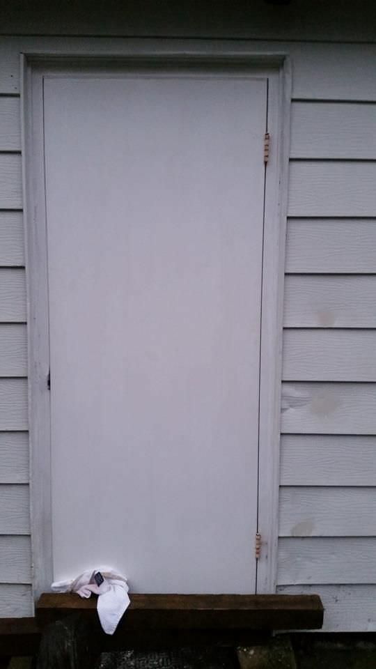

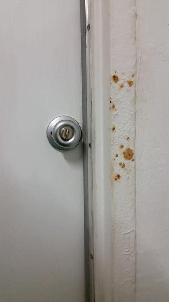

Denray Posted December 22, 2014 Report Share Posted December 22, 2014 A week or so ago my wife tells me that she and her mom want to change out the back door at her mom's house. Meaning I am. This door has been mounted with hinges on the exterior. The jam looks like I can just put in a new door on the interior side. Piece of cake. What the heck are those orange stains on the jam? Click to Enlarge 34.91 KB Wait a minute. Is that jam metal? How am I going to cut a place for the hinge into it? Looks like I'll stick with the exterior hinges, but get the type where the pin can't be taken out. I bring the new door home with NPR hinges. WTF, how do I replace the hing when it's buried behind the metal jam? Click to Enlarge 49.42 KB I'm going to have to use the same worn hinges. So I cut the upper hinge deeper into the door edge to help suck it up tighter to the jam. It all worked out. What would you have done? I never was a professional carpenter, but give me enough time and beer I sometimes figure a way. Plus the new door was an inch shorter so I added some length. Oh, and thicker too. Click to Enlarge 40.06 KB Link to comment Share on other sites More sharing options...
