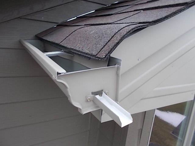

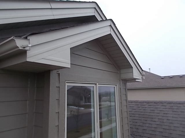

Mike Lamb Posted January 21, 2015 Report Share Posted January 21, 2015 Click to Enlarge 34 KB Click to Enlarge 33.25 KB Quote Link to comment Share on other sites More sharing options...
Jim Baird Posted January 22, 2015 Report Share Posted January 22, 2015 ...very creative. Wonder what catches that focused stream that is like, as we say down South, like a cow p*ssing on a flat rock? Also, the tortured cut and place of those siding pieces above the roof surface, if that is hardi-type siding, is not allowing quite the recommended 3/4" clearance. Quote Link to comment Share on other sites More sharing options...
Mike Lamb Posted January 22, 2015 Author Report Share Posted January 22, 2015 3/4"? The HardiePlank specs I got have a 2" clearance from the roof, a kick-out flashing where the roof terminates, and a 1" gutter clearance from side wall. Quote Link to comment Share on other sites More sharing options...
Tom Raymond Posted January 22, 2015 Report Share Posted January 22, 2015 If they held it 1" off the wall those gutters would be too short to accommodate the hidden hangers. Quote Link to comment Share on other sites More sharing options...

Erby Posted January 22, 2015 Report Share Posted January 22, 2015 C'mon Jim. That focused stream is caught on a flat rock! Quote Link to comment Share on other sites More sharing options...
Jim Baird Posted January 22, 2015 Report Share Posted January 22, 2015 C'mon Jim. That focused stream is caught on a flat rock! Where's the photo? Quote Link to comment Share on other sites More sharing options...
