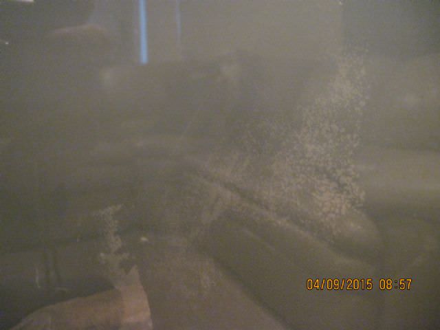

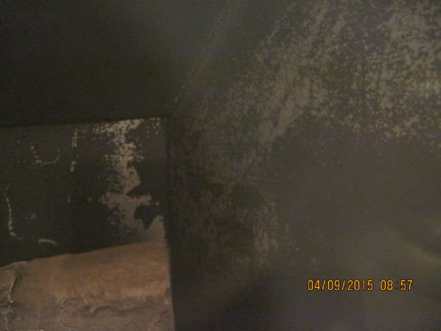

greyboy39 Posted April 9, 2015 Report Share Posted April 9, 2015 Noticed deteriorating paint in the firebox of a natural gas prefab insert today, no signs of any rust. Do you report this condition? If so why? Thanks! Click to Enlarge 26.44 KB Click to Enlarge 32.8 KB Link to comment Share on other sites More sharing options...
Marc Posted April 9, 2015 Report Share Posted April 9, 2015 I see no solid reason to report it. Every house I've ever seen has something much more worthy of the client's ear. Marc Link to comment Share on other sites More sharing options...
Scottpat Posted April 9, 2015 Report Share Posted April 9, 2015 If that is all you are seeing I would not note it. Link to comment Share on other sites More sharing options...
greyboy39 Posted April 9, 2015 Author Report Share Posted April 9, 2015 Thanks guys for your responses, didn't know if this would indicate a failure or eventaul failure of the firebox in some way, shape or form. Yes, there are many other things on this one worthy of the clients ear. Link to comment Share on other sites More sharing options...
Scottpat Posted April 9, 2015 Report Share Posted April 9, 2015 Thanks guys for your responses, didn't know if this would indicate a failure or eventaul failure of the firebox in some way, shape or form. Yes, there are many other things on this one worthy of the clients ear. Johnny, it will eventually fail just like everything else. Right now the paint is just wearing off?. Link to comment Share on other sites More sharing options...
John Kogel Posted April 15, 2015 Report Share Posted April 15, 2015 Thanks guys for your responses, didn't know if this would indicate a failure or eventaul failure of the firebox in some way, shape or form. Yes, there are many other things on this one worthy of the clients ear. Johnny, it will eventually fail just like everything else. Right now the paint is just wearing off?. Scott, your reply 'appears to be servicable'. [] I call that a metal fireplace in good condition. Maybe. I would only be reporting on how well the flame comes on if it operates at all. Link to comment Share on other sites More sharing options...
