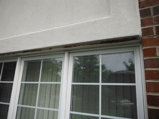

Mike Lamb Posted June 15, 2015 Report Share Posted June 15, 2015 What is the proper detail for EIFS at a steel lintel? Click to Enlarge 39.07 KB Click to Enlarge 35.86 KB Quote Link to comment Share on other sites More sharing options...
Mike Lamb Posted June 15, 2015 Author Report Share Posted June 15, 2015 Shouldn't I be able to see a header flashing? Click to Enlarge 51.08 KB Quote Link to comment Share on other sites More sharing options...
Marc Posted June 15, 2015 Report Share Posted June 15, 2015 Detail for older style of EIFS in that situation was a gap, backer rod and elastomeric sealant. Newer style has drainage plane and weep screed instead. Marc Quote Link to comment Share on other sites More sharing options...
StevenT Posted June 15, 2015 Report Share Posted June 15, 2015 There should be drainage at the bottom of the EIFS and a through wall flashing protecting the lintel. Quote Link to comment Share on other sites More sharing options...
Rob Amaral Posted June 16, 2015 Report Share Posted June 16, 2015 Mike, if you ever get back there to see what is concealed, post it.. I'd love to see that.. Quote Link to comment Share on other sites More sharing options...
mlparham Posted June 16, 2015 Report Share Posted June 16, 2015 That rust tells me that there is water behind the cladding. Quote Link to comment Share on other sites More sharing options...
