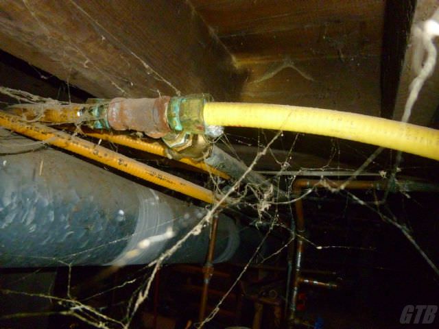

gtblum Posted August 22, 2015 Report Share Posted August 22, 2015 As far as I know, I'm the only inspector who has set foot in this place since it was last sold ten years ago. I don't do soap tests. You think this could be from the original install? Why would it still be there? Click to Enlarge 52.43 KB Link to comment Share on other sites More sharing options...
Jim Katen Posted August 22, 2015 Report Share Posted August 22, 2015 As far as I know, I'm the only inspector who has set foot in this place since it was last sold ten years ago. I don't do soap tests. You think this could be from the original install? Why would it still be there? Click to Enlarge 52.43 KB Were the bubbles hard & crusty or were they still wet? Link to comment Share on other sites More sharing options...
gtblum Posted August 22, 2015 Author Report Share Posted August 22, 2015 They popped like they were wet. No new bubbles after that. Link to comment Share on other sites More sharing options...
Jim Katen Posted August 22, 2015 Report Share Posted August 22, 2015 They popped like they were wet. No new bubbles after that. Every bubble solution that I've ever used dries up within hours. Link to comment Share on other sites More sharing options...
kurt Posted August 22, 2015 Report Share Posted August 22, 2015 Maybe you found Brigadoon. Link to comment Share on other sites More sharing options...
BADAIR Posted August 24, 2015 Report Share Posted August 24, 2015 As far as I know, I'm the only inspector who has set foot in this place since it was last sold ten years ago. I don't do soap tests. You think this could be from the original install? Why would it still be there? Click to Enlarge 52.43 KB wag-around here if gas service is disconnected for a certain period of time the utility provider does a pressure test before resetting the meter if it fails a plumber is called out to locate leak & repair as required before service will be reconnected Link to comment Share on other sites More sharing options...
