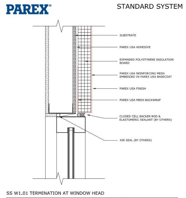

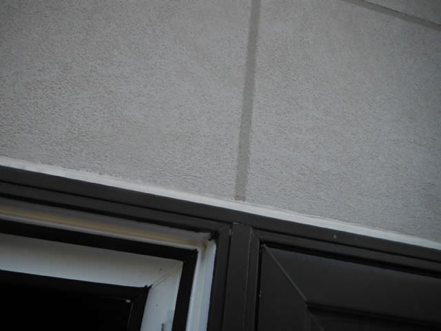

Mike Lamb Posted February 28, 2016 Report Share Posted February 28, 2016 I am looking at the EIMA details for EIFS window header flashing details and the flashing is supposed to be caulked between the flashing and EIFS. Or am I seeing this wrong? How does the water that gets behind the EIFS drain outward above the flashing? Click to Enlarge 34.2 KB Click to Enlarge 34.03 KB Link to comment Share on other sites More sharing options...
Mike Lamb Posted February 28, 2016 Author Report Share Posted February 28, 2016 Click to Enlarge 37.34 KB Link to comment Share on other sites More sharing options...
Scottpat Posted February 28, 2016 Report Share Posted February 28, 2016 The diagram looks like it is for the first generation EIFS or barrier type system. The idea of the header flashing was to make sure that the water did not get behind the window, not to direct water out of the system like through wall flashing, etc? With the second generation or drainable systems the moisture barrier or stucco wrap would be over the top of that flashing detail so that any water that would drain onto the flashing. In other words it would not be sealed like your diagram.. Clear as mud?? The flashing details in the photos actually look pretty good as do the sealant around the window. Link to comment Share on other sites More sharing options...
Mike Lamb Posted February 28, 2016 Author Report Share Posted February 28, 2016 Thanks, Scott. That is definitely clear as mud. This is new construction. Is there an updated EIMA that I can't find? So this may or may not be wrong? As is, this does not make sense to me. Link to comment Share on other sites More sharing options...

Mike Lamb Posted February 28, 2016 Author Report Share Posted February 28, 2016 I am pretty sure I have seen EIFS with an un-caulked header flashing. This is another specification that shows otherwise. Click to Enlarge 44.41 KB Link to comment Share on other sites More sharing options...
Scottpat Posted February 29, 2016 Report Share Posted February 29, 2016 I am pretty sure I have seen EIFS with an un-caulked header flashing. This is another specification that shows otherwise. Click to Enlarge 44.41 KB That's a diagram for a barrier system also? EIMA has taken their diagrams down but this site has some fairly good ones. They cover drainage system EIFS. http://www.wallsystemdesign.org/content ... tails-eifs Link to comment Share on other sites More sharing options...
Mike Lamb Posted February 29, 2016 Author Report Share Posted February 29, 2016 I have not seen a distinction for barrier system vs. drainage system? in any specs I have looked at. Do you have any specs for a non-barrier installation for EIFS? Link to comment Share on other sites More sharing options...
BADAIR Posted February 29, 2016 Report Share Posted February 29, 2016 I have not seen a distinction for barrier system vs. drainage system? in any specs I have looked at. Do you have any specs for a non-barrier installation for EIFS? all mfr have specs for each of their systems generally these should apply and mirror eima or vice versa http://www.dryvit.com/fileshare/doc/uk/ ... duk504.pdf Link to comment Share on other sites More sharing options...
