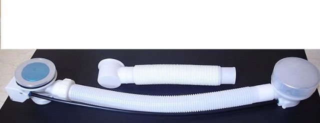

dliang Posted April 15, 2016 Report Share Posted April 15, 2016 Hello guys, First post to TIJ I got a question on if attached plastic corrugated tubing in compliance with Code such as IPC, UPC. From my understanding, such corrugated design will accumulate dirt and will be clogged in long term. So I am thinking it was in conflict with UPC 310.5 I also see some copper corrugated tubing in the market. would like to see others opinion on such corrugated tubing. Click to Enlarge 17.62 KB Quote Link to comment Share on other sites More sharing options...
Jim Katen Posted April 15, 2016 Report Share Posted April 15, 2016 I agree that it's a problem. Your code reference is odd though. Perhaps you meant 701.2.3: Fittings used for drainage shall be of the drainage type, have a smooth interior waterway, and be constructed so as to allow one fourth (1/4) inch per foot (20.9 mm/m) grade. Quote Link to comment Share on other sites More sharing options...
Jim Katen Posted April 15, 2016 Report Share Posted April 15, 2016 Another thought: Are you sure that those aren't smooth on the inside? I've seen some drain tubing that was corrugated on the outside and smooth on the inside. Quote Link to comment Share on other sites More sharing options...
Nolan Kienitz Posted April 15, 2016 Report Share Posted April 15, 2016 Another thought: Are you sure that those aren't smooth on the inside? I've seen some drain tubing that was corrugated on the outside and smooth on the inside. Good thought, but I'm not taking it apart to find out if the "installed product" has an interior smooth wall. I continue to go with it's OK for "temporary, emergency" use ... Not a permanent installation. Quote Link to comment Share on other sites More sharing options...
dliang Posted April 18, 2016 Author Report Share Posted April 18, 2016 Thank you Jim, It seems you are reference 701.3.3 and I agree that section is better fit for it, especially for the interior waterway. I review the product, the inside is same as outside corrugated. The other problem is such tubing is flexible and may not be able to achieve the slop in 701.3.3 I agree that it's a problem. Your code reference is odd though. Perhaps you meant 701.2.3: Fittings used for drainage shall be of the drainage type, have a smooth interior waterway, and be constructed so as to allow one fourth (1/4) inch per foot (20.9 mm/m) grade. Quote Link to comment Share on other sites More sharing options...
