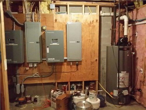

Jon Hodgkins Posted July 19, 2016 Report Share Posted July 19, 2016 This bell was tied into the electrical panel. Does anyone know what it could be for? The homeowner had no idea. They do have an automatic backup generator. The only connection I noticed was a conduit connection between the bell and the breaker panel. Bell's manufacturer is LEE - Model #E31780 Thanks Click to Enlarge 4.22 KB Click to Enlarge 43.04 KB Quote Link to comment Share on other sites More sharing options...
Chad Fabry Posted July 19, 2016 Report Share Posted July 19, 2016 Is there an effluent pump? Quote Link to comment Share on other sites More sharing options...
Jon Hodgkins Posted July 19, 2016 Author Report Share Posted July 19, 2016 I am not sure, but agree that this could be a likely suspect. They are usually labeled when I see them. The relay wire is probably fed through the back of the alarm through the plywood - which is why I only could see the conduit, which is probably for the power supply. Is there anything electrically that could warrant a need for an audible alarm? Quote Link to comment Share on other sites More sharing options...
Rob Amaral Posted July 20, 2016 Report Share Posted July 20, 2016 Only alarms I see are for pumps... (Sewage).. I can see somebody doing it for a sump (basement dewatering) type pump I guess... Quote Link to comment Share on other sites More sharing options...
