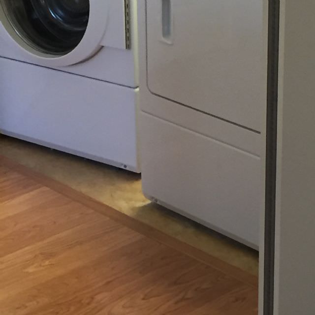

cordelia Posted August 7, 2016 Report Share Posted August 7, 2016 I have noticed a small amount of white residue forming under my dryer. It seems to be coming out from under it and spreading a little in front of the door. I assume from what I have read here and elsewhere that it is just a small amount of buildup from condensation. My home is about 7 years old and the washer and dryer are working fine (dryer is very efficient and quick to dry). The washer/dryer are side-by-side in a closet where the temperatures get quite warm and humid in the summer, which is the first time I noticed this white substance. I've been cleaning it up every few weeks. My dryer gets used minimally b/c my clothes come out nearly dry from the front loader washer. And, I've noticed this build-up even when the machine is not in use. Any ideas would be appreciated. Quote Link to comment Share on other sites More sharing options...
Scottpat Posted August 8, 2016 Report Share Posted August 8, 2016 Gas dryer? Quote Link to comment Share on other sites More sharing options...
Nolan Kienitz Posted August 8, 2016 Report Share Posted August 8, 2016 Just to satisfy your curiosity have you pulled the dryer out and have a close, unobstructed view behind and under same? NOt sure what you might see, but there may be clues. Quote Link to comment Share on other sites More sharing options...
Jim Katen Posted August 8, 2016 Report Share Posted August 8, 2016 I have noticed a small amount of white residue forming under my dryer. It seems to be coming out from under it and spreading a little in front of the door. . . . Is it on the dryer, on the floor, or what? Is it wet or dry? Is it soft, like lint, or hard, like mineral deposits? Do you have a picture of it? Quote Link to comment Share on other sites More sharing options...
cordelia Posted August 8, 2016 Author Report Share Posted August 8, 2016 Thanks for the replies. The dryer is electric. The white residue looks like dried white salt debris, like what you carry onto your floors in the winter time when there is ice melt/salt on sidewalks. Just a thin white dried residue that looks like mineral/salt deposits. Nothing is wet. Sometimes I see a slightly damp patch right under the dryer, but now that I've left the doors open to that closet, the floor looks dry. Behind the washer/dryer, the water valves and drainage look clean and perfectly intact. Under the washer is totally dry. I'm guessing since there is a little of this powdery substance emanating from under the entire dryer that this has to do with the venting and/or humidity. I haven't been able to move the dryer myself. I'm including a picture. It's not great, but you can see a little bit of a white patch at the left corner of the dryer and a little bit under the front of the machine. The white residue also runs along the front of the washer/dryer area against the wood, but it's very faint and not visible here. Thanks. Click to Enlarge 31.8 KB Quote Link to comment Share on other sites More sharing options...
Jim Katen Posted August 9, 2016 Report Share Posted August 9, 2016 Clean it up really well, make sure that it's completely dry, and then place a sheet of children's colored construction paper right there. Then see what happens. The construction paper will readily show if it gets wet and where the water is coming from. Quote Link to comment Share on other sites More sharing options...
Jim Baird Posted August 9, 2016 Report Share Posted August 9, 2016 ...if the powder looks water-borne it probably is. Front loaders, just by common sense, look more likely to lose some water during operation. Quote Link to comment Share on other sites More sharing options...
