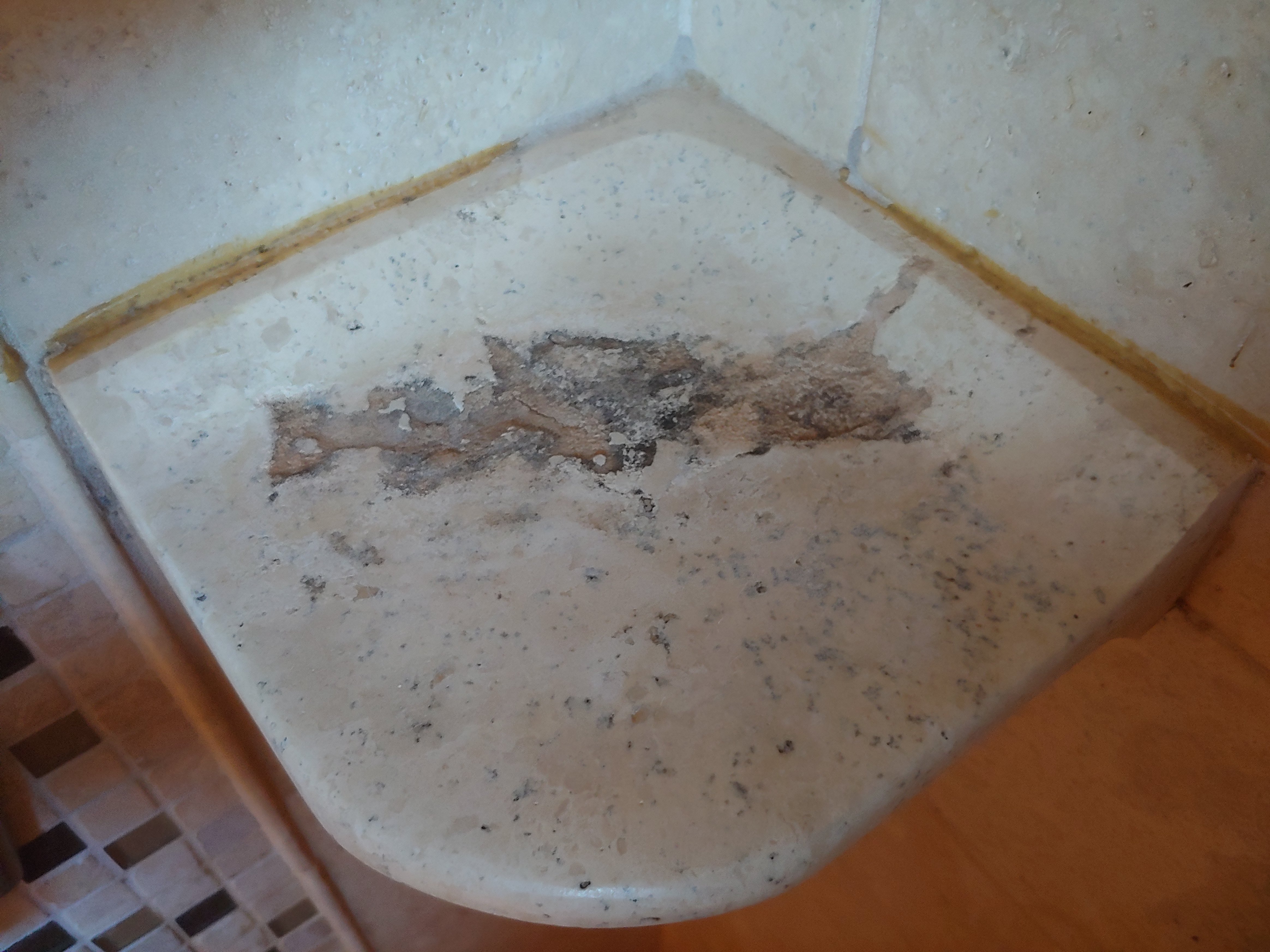

Whalen68 Posted November 5, 2019 Report Share Posted November 5, 2019 My shower has a matching soap dish that has a nasty gouge right through the center. It is rather shallow but I would like to fill it with a matching grout. If I use grout should I use should I use sanded or unsanded? Are there other option to fill the gash with something other than grout? Do I need to use some type of adhesive or cleaner before application? I appreciate the assist. Quote Link to comment Share on other sites More sharing options...
Jim Katen Posted November 6, 2019 Report Share Posted November 6, 2019 Is the gouge in a glazed portion of ceramic? If so, I'd call someone who can apply epoxy that could be buffed to match the surrounding sheen. Unless you can match the color perfectly, I'd suggest a kintsugi-style repair in which you make no effort to hide the fact that it's a repair. Quote Link to comment Share on other sites More sharing options...
Whalen68 Posted November 6, 2019 Author Report Share Posted November 6, 2019 Here's a picture. I forgot to include it with the original post. The gouge is on the top side of the dish. I am puzzled how it happened. I was not in the house when this occurred. Anyhow, I am not terribly concerned about a perfect match. I only want to get close to the existing color. More importantly, I want to get a smooth surface. Right now, you run the risk of cutting a finger. I appreciate the advice. Quote Link to comment Share on other sites More sharing options...
Bill Kibbel Posted November 6, 2019 Report Share Posted November 6, 2019 There's stone/tile repair kits available just for that type of issue. They're usually between $15 - $20. Quote Link to comment Share on other sites More sharing options...
