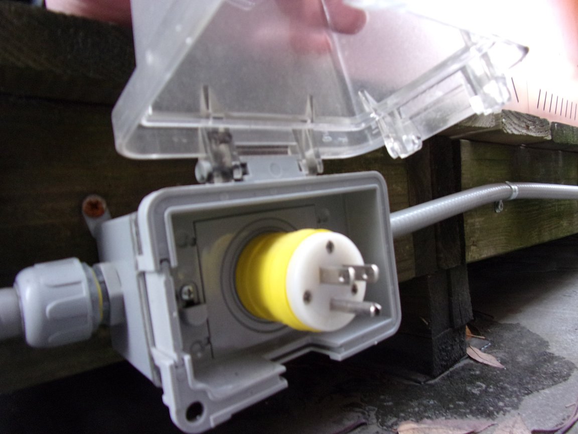

SNations Posted January 20, 2022 Report Share Posted January 20, 2022 I saw this on the roof of a townhouse in Chicago. Does anybody know what this might be for? Link to comment Share on other sites More sharing options...
Mike Lamb Posted January 21, 2022 Report Share Posted January 21, 2022 Looks like a locking plug? What were those cables feeding? Link to comment Share on other sites More sharing options...
Scott Malkinson Posted January 23, 2022 Report Share Posted January 23, 2022 It's a jury rigged, homemade, 15A 125V power inlet Link to comment Share on other sites More sharing options...
Scott Malkinson Posted January 23, 2022 Report Share Posted January 23, 2022 https://www.homedepot.com/p/AC-WORKS-15-Amp-125-Volt-NEMA-5-15P-Flanged-Power-Input-Inlet-ASIN515P/305436657 Link to comment Share on other sites More sharing options...
Jim Katen Posted January 23, 2022 Report Share Posted January 23, 2022 I think someone was intending to use it as a inlet for a generator on the roof. It's wrong. Link to comment Share on other sites More sharing options...
