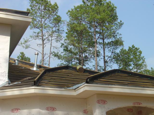

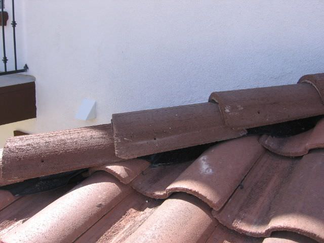

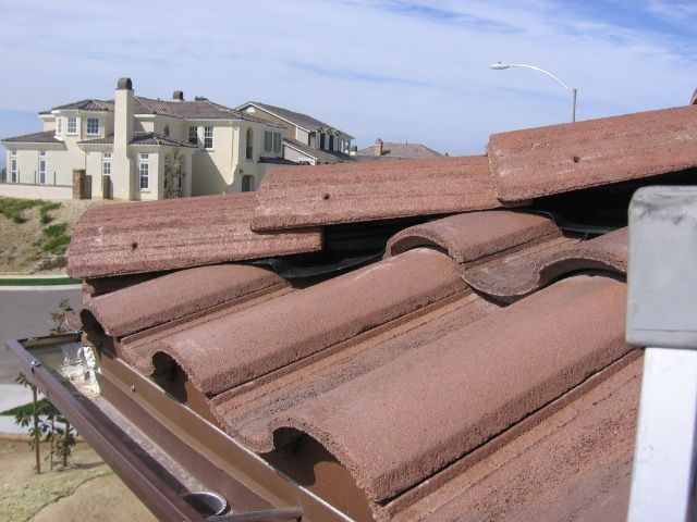

Martin Lehman Posted March 15, 2006 Report Share Posted March 15, 2006 On this roof I found that there was exposed wood under the hip tiles. What is this all about? Also all of the hip tiles had a plastic type of flashing under them and none of them were nailed in. Should that platic be covered up with mortar? Download Attachment: IMG_2714.jpg 120.94 KB Download Attachment: IMG_2724.jpg 102.11 KB Download Attachment: IMG_2725.jpg 112.54 KB Link to comment Share on other sites More sharing options...
mgbinspect Posted March 15, 2006 Report Share Posted March 15, 2006 The wood looks to serve as a shim to create a consistant slope to the hip tiles. Beyond that I'm lost. I only see a tile roof about once every three years here. How do you know that the tiles aren't fastened? Could there be some form of anchorage cast into the underside of the product that you can't see? I wish I knew more about this roofing system myself. Link to comment Share on other sites More sharing options...
Martin Lehman Posted March 15, 2006 Author Report Share Posted March 15, 2006 Shouldn't the wood be one continuous piece? Or at least covered? The tiles may be nailed under the headlap, or anchored, but I can't tell. However, the exposed nail holes are not being used - and I am unsure if they are supposed to be filled with nails. mgbinspect - what type of roof do see out there? Link to comment Share on other sites More sharing options...

DonTx Posted March 16, 2006 Report Share Posted March 16, 2006 There should be a continuous ridge, normally it's a 2x6 standing on end, covered with 2 layers of grade D felt paper then most will nail a batten strip on top after the paper is on. That picture looks like they took a few shortcuts. This might help you. Download Attachment: DSC01089.JPG 64.18 KB Link to comment Share on other sites More sharing options...
Martin Lehman Posted March 16, 2006 Author Report Share Posted March 16, 2006 Thanks for the visual Donald, amazing how a picture can really clear things up for me. The roofer on this new home really took some short cuts. There were numerous problems, but as far as I can see the hack job on these ridges and hips is [:-censore up. Link to comment Share on other sites More sharing options...
hausdok Posted March 16, 2006 Report Share Posted March 16, 2006 I'm interested in the plastic stuff. It looks almost like a stiff ABS-like plastic that's been pre-formed for that specific application. Is that what it looked like? OT - OF!!! M. Link to comment Share on other sites More sharing options...
Martin Lehman Posted March 16, 2006 Author Report Share Posted March 16, 2006 Yeah Mike, It was very stiff. And nailed to the boards benieth. Download Attachment: IMG_2713.JPG 111.6 KB Link to comment Share on other sites More sharing options...
hausdok Posted March 16, 2006 Report Share Posted March 16, 2006 Obviously molded. I'm thinking the manufacturer of the roofing product probably includes it as part of the system. OT - OF!!! M. Link to comment Share on other sites More sharing options...
Martin Lehman Posted March 16, 2006 Author Report Share Posted March 16, 2006 Ok, finally.[:-crazy] I found out what this stuff is - "So-Lite" - Ridgid, formed plastic that eliminates the need for mortar at the hip/ridge/wall areas of a roof. Weather-Blocking, New Web Site Highlight Rooferââ¬â¢s Meeting by Joe Wheeler From The Construction Zone: September 2000 The Roofing Contractors Association of Nevada (RCAN) featured two speakers at their crowded August meeting at ABC Supply in Las Vegas. Debi Roberts, Vice President of Sales & Marketing for So-Lite Manufacturing, demonstrated the latest in weather-blocking solutions from the California manufacturing company. The Uniform Building Code requires that, "Tile of clay or concrete... shall be installed in accordance with the manufacturerââ¬â¢s instructions." Since 1994, most manufacturers call for weather-blocking at hips, ridges and headwalls. Roberts said that So-Liteââ¬â¢s U.V. resistant/weatherable hip and ridge closure weather-block was designed 17 years ago by Eric Reeves, a roofer by trade who owned a tile roofing company in California. Reeves noticed a problem with ridge and hip joints; thatââ¬â¢s where rain intruded into the roof, often causing the contractor to do repairs under warranty. Reeves solved this by designing a weather-block that was "ridge specific," in other words, designed to fit perfectly with certain manufacturerââ¬â¢s existing tile to provide a water preventive seal. Today, So-Lite provides weather-blocking for manufacturers MonieLifetile, Eagle, Pioneer, Westile, Maxitile, Vostile and others. Roberts demonstrated how the various types of weather-blocking made by So-Lite, and how to install the material to obtain the correct seal. Visit Sol-Lite on the web at www.so-lite.com Thanks for the help everyone Link to comment Share on other sites More sharing options...
