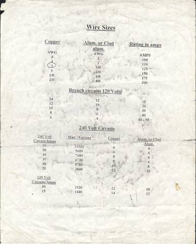

hausdok Posted October 19, 2006 Report Share Posted October 19, 2006 Here, This might be easier to use. I scanned the thing. Save it and then blow it up and print it out on cardstock. I don't remember where I got it but I can tell you that it's at least 9 years old and shows it after bouncing around in my clipboard for that long. OT - OF!!! M. Download Attachment: CableSizes.jpg 27.34 KB Quote Link to comment Share on other sites More sharing options...
