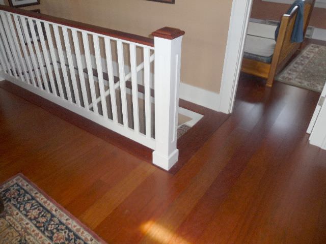

Richard Moore Posted February 24, 2009 Report Share Posted February 24, 2009 Yeah, I could see myself making a complete mess that way. My other concern was that I would be rushed into a screw-up by the limited tack time. The glue-together method was also time consuming, but I was in no real hurry. It gave me the luxury of carefully selecting each piece for match and/or contrast and taking breaks whenever I felt like it. Actually fun and one of the more "instantly" gratifying things I remember doing. All the transitions were made in my shop out of solid Jatoba (Brazilian cherry). Just took a few photos of the tidier areas... Click to Enlarge 47.49 KB Click to Enlarge 94.58 KB Click to Enlarge 47.91 KB BTW, in case you were wondering: the mattress from the guest bedroom (1st photo) is currently on the floor in the dining room. I've been sleeping down there the last 6 weeks while my dog recovers from leg surgery. He gets a new x-ray tomorrow, and if all is well, we can let him back upstairs and return to a normal life. Yeah...we spoil him...just a little! Quote Link to comment Share on other sites More sharing options...
Brandon Whitmore Posted February 24, 2009 Author Report Share Posted February 24, 2009 I thought maybe the wife kicked you out of the bedroom, so you took the matress with you out of spite. [^] Your pictures make me want to start remodeling my own place--- that flooring looks great. I'm too nervous to spend any money on upgrades right now, but one of these days........... Quote Link to comment Share on other sites More sharing options...
