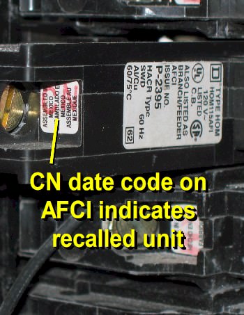

Richard Moore Posted May 2, 2007 Report Share Posted May 2, 2007 I had a wierd one yesterday. 2003 house, panel signed off in December, 2003. Two circuits labeled as "bedroom plugs". One of these had an AFCI manufactured in March, 2004. No AFCI on the other. I'm guessing that the 2002 codes hadn't been adopted yet. Anyway...first time I've seen an AFCI added without any remodeling. Oh, and of course it's one of the recalled Square-D breakers! Download Attachment: 0084.JPG 59.42 KB Quote Link to comment Share on other sites More sharing options...
