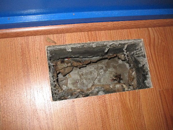

Richard Moore Posted June 7, 2007 Report Share Posted June 7, 2007 Ok...this is new for me. 1951 rambler, on a slab (which is rare around here). The furnace heat supply ducts appear to be no more than cardboard form tubes embedded in the slab and cut out at each register opening. No signs of any coating (asbestos, etc), just a lot of dust and dirt. Normal return ductwork, through the attic. Anyone seen this before? Very good air flow at all registers, but it just don't seem right. Comments? Download Attachment: 0034.jpg 108.2 KB PS...the Pergo installed over the carpet was a nice touch (and a separate issue). Finally, the Coleman furnace appeared to be brand, spanking new but the serial numbers don't seem to conform to anything I've seen on the various forums. Model FC85080A12DH11B, Serial # W0B7424908. Anyone able to shed some light there? Link to comment Share on other sites More sharing options...
Bill Kibbel Posted June 7, 2007 Report Share Posted June 7, 2007 Very common here for mid 1940s through 1960 slab homes. If'n it aint asbestos it's paper ducts. Almost always eaten by termites and collapsing. When you turn on the blower, the house smells like a dirt crawlspace. Link to comment Share on other sites More sharing options...
Richard Moore Posted June 7, 2007 Author Report Share Posted June 7, 2007 Hi Bill, I'm recommending duct cleaning, not only because they were filthy, but to ensure no blockages. It's doubtful our NW types of termites (subs & dampwood) would find the conditions particularly appealing. My thinking is that as long as there's good airflow and it's been this way for 50+ years, it's really not a big deal. Even if the cardboard has deteriorated, there's still a "tunnel" in the slab. What do you do when you find these? Link to comment Share on other sites More sharing options...
Bill Kibbel Posted June 7, 2007 Report Share Posted June 7, 2007 The slabs aren't that thick here. Most of the tube is in contact with damp soil. The soil is kept warm all winter so the termites are happy to extend their season. I remember one that had decent air flow, but the air lost all its heat before arriving at the vents. Link to comment Share on other sites More sharing options...

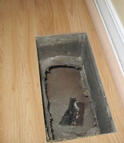

Richard Moore Posted June 7, 2007 Author Report Share Posted June 7, 2007 Here's a photo of another area of the house. Download Attachment: 0035.jpg 50.3 KB The bottoms of the tubes looked to be in good condition with only the cut-out areas kind of ragged. I don't actually know if the slab extends down around them though. Link to comment Share on other sites More sharing options...
Jim Morrison Posted June 7, 2007 Report Share Posted June 7, 2007 Sounds like an allergen farm to me. My experience with these things (they are rare in MA) is nearly identical to Bill's. I can't remember one with decent air flow. I wonder if the duct material would survive a good brushing and vacuuming? Link to comment Share on other sites More sharing options...
