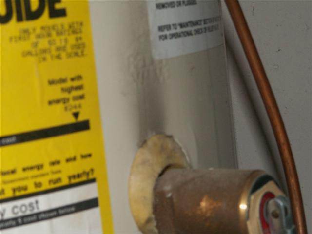

fqp25 Posted June 15, 2007 Report Share Posted June 15, 2007 Back on Feb 1, 07 there was a thread named HOT HOT WATER HEATER. There was a water heater which had big scorch marks around the tank drain. J Katen also posted a similar picture of effects of a collapsed baffle. Today I saw scorch marks around the TPR valve of a 17 year old AO Smith WH. The area around the drain did not have any marks. Could this also be a collapsed baffle? Image Insert: 123.55 KB Image Insert: 93.38 KB Link to comment Share on other sites More sharing options...
hausdok Posted June 15, 2007 Report Share Posted June 15, 2007 Could be. Probably is. If I had a 17 y.o. gas water heater, I'd be saying something like, "This tank is kinda like Granddad. It's in the nursing home on life support and the staff doesn't know why he's still hanging on. Don't be surprised if it "expires" in the not-to-far-distant future. In fact, if I get my truck out of the driveway without it failing, I'll be surprised. These are cheap - a few hundred bucks installed. Get a new one now." It always gets the realtor ladies all wound up! No seismic restraint in Illinois, huh? ONE TEAM - ONE FIGHT!!! Mike Link to comment Share on other sites More sharing options...
