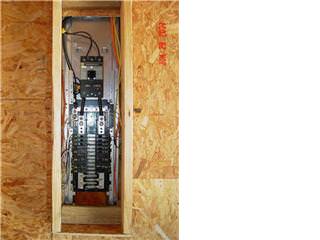

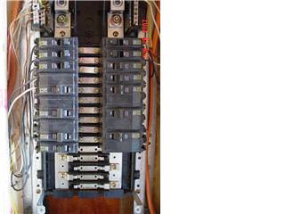

Brian G Posted June 30, 2007 Report Share Posted June 30, 2007 Yesterday I did a house with a detached garage, both just 2 years old. In the garage I found where someone had taken a panelboard out of a commercial/industrial breaker panel and mounted it in a wall cavity (the walls were sheathed inside with OSB). It still had the interior covers to keep fingers out, but no enclosure at all. Wires were just run into the cavity, stripped, and hooked up. This was a 200 amp, 30 circuit Square D panelboard with bolt-on breakers. The main was a big ole' shunt-trip unit. I've never seen anything like it. Anybody else? Of course, I told them how lucky they were to get such an expensive panelboard in the deal. [] Brian G. "Further Investigation Recommended" [:-mischie Heck, I can't remember ever seeing a bolt-on panel in a house before. Image Insert: 14.69 KB Image Insert: 11.64 KB Image Insert: 12.93 KB Quote Link to comment Share on other sites More sharing options...
John Dirks Jr Posted June 30, 2007 Report Share Posted June 30, 2007 Woah!!! Thats like a junction box without a cover x 100 to the tenth power. When you consider that heated wires from overloaded circuits are most likely to happen in the main panel, its quite dangerous to say the least. Quote Link to comment Share on other sites More sharing options...
Brian G Posted July 1, 2007 Author Report Share Posted July 1, 2007 Hey Jim, 'zacktly what is shunt-trip breaker good for anyway? Brian G. Shunt 'Cho Mouth (I'z Just Talkin' 'Bout Shaft) [:-censore Quote Link to comment Share on other sites More sharing options...
Jim Katen Posted July 1, 2007 Report Share Posted July 1, 2007 Originally posted by Brian G. Hey Jim, 'zacktly what is shunt-trip breaker good for anyway? Brian G. Shunt 'Cho Mouth (I'z Just Talkin' 'Bout Shaft) [:-censore In this case, I have no idea. Was it set up to be switched off from the house or something? Shunt trip breakers are just remote control breakers. I believe they use a solinoid to literally kick the breaker off. I think they only work one way. That is, once tripped, you've got to reset the breaker manually. The only place I've heard of them being used is in conjunction with fire systems. A fire system might be set to shunt trip an exhaust fan or an elevator for instance. If the shunt wires aren't connected to anything, I don't see how it would cause anyone any problems in a garage though. - Jim Katen, Oregon Quote Link to comment Share on other sites More sharing options...
Brian G Posted July 1, 2007 Author Report Share Posted July 1, 2007 Originally posted by Jim Katen In this case, I have no idea. Was it set up to be switched off from the house or something? No, I think this is just a case of someone getting their hands on a panelboard that had no enclosure, which they decided to use anyway. I suspect it walked off a commercial or industrial jobsite someplace; a shunt-trip main and bolt-on branches? On top of everthing else there was nothing in the garage but plain ole' 110v outlets and switches. Shunt trip breakers are just remote control breakers. I believe they use a solinoid to literally kick the breaker off. I think they only work one way. That is, once tripped, you've got to reset the breaker manually. Ah-so. It's a remote control crazy society we live in, no? The only place I've heard of them being used is in conjunction with fire systems. A fire system might be set to shunt trip an exhaust fan or an elevator for instance. Interesting. One system controlling another. If the shunt wires aren't connected to anything, I don't see how it would cause anyone any problems in a garage though. They weren't, and I don't have concerns about that part. It's the "no enclosure" thing that concerns me most, with all that entails. Brian G. Get A Can or Get a New Panel [:-bigeyes Quote Link to comment Share on other sites More sharing options...

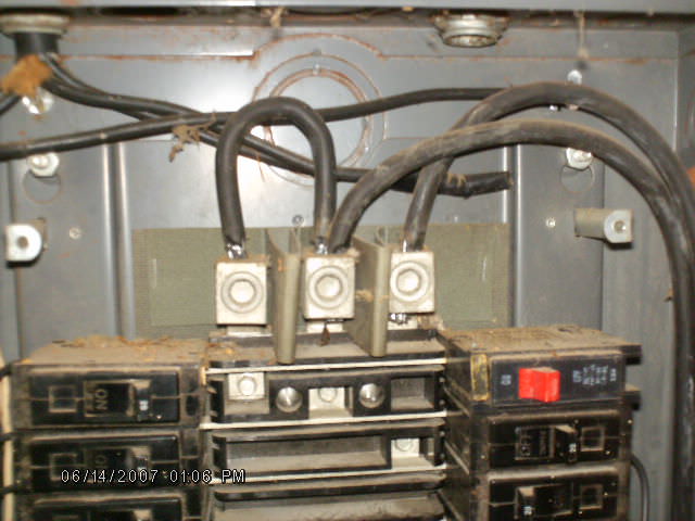

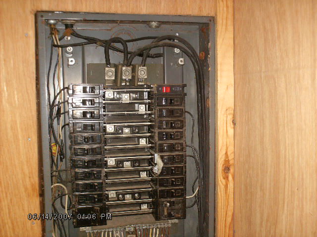

Phillip Posted July 1, 2007 Report Share Posted July 1, 2007 This is one I run into the other day. A 3 phase panel some one tried to rig as a single phase. It is not like yours but it is another case of someone using the wrong panel. Image Insert: 102.55 KB Image Insert: 116.44 KB Quote Link to comment Share on other sites More sharing options...
