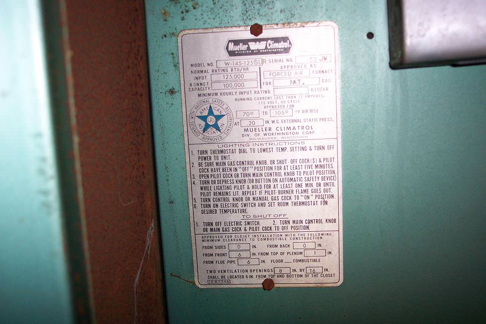

John Dirks Jr Posted July 19, 2007 Author Report Share Posted July 19, 2007 Its a Mueller Climatrol and it keeps my little brick rancher nice and toasty in the winter. Can anyone look at the picture and tell me where the pilot adjust screw is? Image Insert: 119.11 KB Image Insert: 102.84 KB Link to comment Share on other sites More sharing options...
