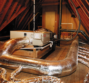

RobC Posted April 25, 2004 Report Share Posted April 25, 2004 Mike, Isn't the condensate trap installed backwards in the photo? Download Attachment: UNICO.jpg 72.08 KB Quote Link to comment Share on other sites More sharing options...
hausdok Posted April 25, 2004 Report Share Posted April 25, 2004 Hi, Good eye Rob, I'd say so. Except, it looks like the outlet from the trap is low enough to ensure that it drains before it gets so high that it is backing up into the unit. Still, not the best photo in the world to use with that article. I wonder if subsequent issues of PM had letters from readers commenting on it? OT - OF!!! M. Quote Link to comment Share on other sites More sharing options...
RobC Posted April 25, 2004 Report Share Posted April 25, 2004 I was going to mention the incorrect placement of the ducts and attachement method but we'll leave it at that.[] Quote Link to comment Share on other sites More sharing options...
