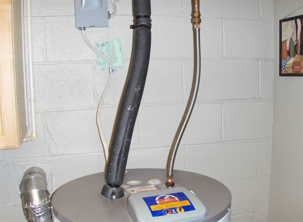

John Dirks Jr Posted April 6, 2008 Report Share Posted April 6, 2008 This is the first time I have seen braided used for water heater connections. Is this accepable? Image Insert: 86.21 KB Link to comment Share on other sites More sharing options...
Richard Moore Posted April 6, 2008 Report Share Posted April 6, 2008 Don't know about code. From a "safety" point of view, they are probably fine on an electric water heater but I think would be wrong next to the draft hood of a gas model. But, I would still be concerned about the internal diameter of the "washing machine" type hoses and how that might effect flow rates (although these do look fairly "beefy"). Actually, the top nut, at least, looks "purpose built" and not just a normal hose bib connector. Unfortunately, it looks like they have removed the labels that might have listed their use for this purpose. Normal metal flex connectors aren't that expensive, and I don't think anyone would fault you for expressing you concerns and recommending they be changed. Link to comment Share on other sites More sharing options...
Bill Kibbel Posted April 6, 2008 Report Share Posted April 6, 2008 There are braided stainless steel connectors specifically manufactured and approved for water heaters. The tubing is Santoprene (cross linked EPDM and polypropylene). Link to comment Share on other sites More sharing options...
Richard Moore Posted April 6, 2008 Report Share Posted April 6, 2008 Bill...would they be OK for a gas water heater? I did find some at an Ace Hardware site and they list the ID as 5/8 so that would remove that concern. Link to comment Share on other sites More sharing options...
John Dirks Jr Posted April 6, 2008 Author Report Share Posted April 6, 2008 Originally posted by inspecthistoric There are braided stainless steel connectors specifically manufactured and approved for water heaters. The tubing is Santoprene (cross linked EPDM and polypropylene). [:-thumbu] You just made my report one picture and one paragraph shorter. Link to comment Share on other sites More sharing options...
Bill Kibbel Posted April 7, 2008 Report Share Posted April 7, 2008 Originally posted by Richard Moore Bill...would they be OK for a gas water heater? I did find some at an Ace Hardware site and they list the ID as 5/8 so that would remove that concern. I installed a pair last year when I replaced one of my water heaters (electric). They're made by Watts; Series CWH-S flexible water supply connectors for water heaters. NSF and UPC Listed. "These connectors provide full flow capacity and protection from vibration and bursting under pressure surges and seismic activity". There is no information, label, etc. warning that they are not suitable for gas or lp. Link to comment Share on other sites More sharing options...
