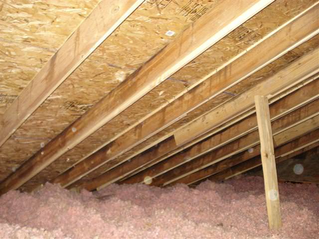

Erby Posted April 8, 2008 Report Share Posted April 8, 2008 I'm used to seeing new rafters sistered in along side existing sagging rafters. However, today I ran into 1x8 sisters. I'm not sure of the correctness of this. Any thoughts. Image Insert: 76.12 KB Quote Link to comment Share on other sites More sharing options...
StevenT Posted April 8, 2008 Report Share Posted April 8, 2008 Hi Erby, If they are sistered because of sagging, especially if they're sagging because of the weight/span, I don't have too much faith in them. But, If the are sistered as nailers because the seams of the sheathing don't fall out right, well, I see that quite a bit, and I don't have a problem with it. Quote Link to comment Share on other sites More sharing options...
AHI in AR Posted April 8, 2008 Report Share Posted April 8, 2008 I would question that approach. I can't tell what the span is, but the pitch looks low, and that makes bracing more critical. If a 2X didn't carry the load, I don't think that added 1x's will do much. Without knowing what the horizontal run is before they are braced, I can't say for sure...but I suspect they need to add additional bracing to shorten the span. There look to be too many 1X's added for them to have been done for nailing purposes. Quote Link to comment Share on other sites More sharing options...
inspect4u Posted April 9, 2008 Report Share Posted April 9, 2008 I agree, I don't see a 1x doing much good in that situation. If the the rafters are sagging in that area, adding a purlin would seem a better fix. Also, you cannot brace a roof off of a ceiling joist. I can't tell from the photo if that brace is sitting on a top wall plate, beam, or ceiling joist. I have seen 1x's nailed to the side of rafters before because there was a splice in the rafter and there was no bracing added. Now that is just a sorry framer using scraps!! Mike M Quote Link to comment Share on other sites More sharing options...
kurt Posted April 9, 2008 Report Share Posted April 9, 2008 Also, those sisters look like punky white tree farm wood. I doubt they contribute anything at all to stiffening the rafters. Quote Link to comment Share on other sites More sharing options...
Eagle Eye Posted April 9, 2008 Report Share Posted April 9, 2008 Man you guys have better eyes then Old Eagle Eyes, I can't even tell what's what in the picture. How much deflection was present at the time of inspection and what did the roof feel like when you walked on it? Also what is the age of the house, I see the OSB but how old is the house? Quote Link to comment Share on other sites More sharing options...
Erby Posted April 11, 2008 Author Report Share Posted April 11, 2008 Don't matter now though I thought I'd uploaded three pictures. Anyway I suggested replacement or engineering approval letter. Roofer is taking the shingles and sheathing off and replacing the rafters with "real" rafters. Quote Link to comment Share on other sites More sharing options...
