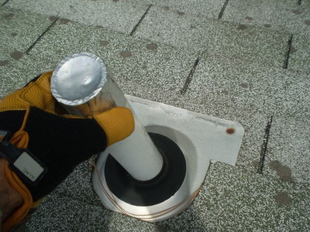

tnpappas Posted July 27, 2009 Report Share Posted July 27, 2009 There are a couple of vent stacks on this roof that were covered with foil tape. These vents wobbled back and forth quite a bit because they were cut off in the attic. Would you suggest to have them removed and the roof repaired, or terminated with a better method? Click to Enlarge 77.31 KB Click to Enlarge 27.16 KB Quote Link to comment Share on other sites More sharing options...
Mark P Posted July 27, 2009 Report Share Posted July 27, 2009 I think the bigger question is what were these vents intended for and why are they not hooked up? Is the plumbing system vented or where these suppose to be the vents and they never got hooked up? Was there a remolding job and the vents have been moved and these are old? Anyway to answer your question, I would say if they are not needed have them removed and the roof patched the next time the roof is replaced, unless you see signs of a probelm. I'm sure you'll get different opinions. Quote Link to comment Share on other sites More sharing options...
AHI in AR Posted July 27, 2009 Report Share Posted July 27, 2009 That's a little odd that someone would leave things like that. Sooner or later, the tape will fail. Probably before that time, though, the boot seal will lose its grip and the pipe will fall through the roof. If it's a long enough drop to the ceiling it could knock a hole in the drywall. But if not, it may not be noticed until there's a rainstorm. It wouldn't be very expensive to have the holes patched and the area reroofed. That would be my recommendation. Quote Link to comment Share on other sites More sharing options...
tnpappas Posted July 27, 2009 Author Report Share Posted July 27, 2009 These were terminated due to a remodel. Quote Link to comment Share on other sites More sharing options...
Rocon Posted July 27, 2009 Report Share Posted July 27, 2009 Additionaly the PVC exposed to Ultraviolet light with cause the plasticisers to migrate. Eventually it will be a problem. Quote Link to comment Share on other sites More sharing options...
Mark P Posted July 27, 2009 Report Share Posted July 27, 2009 Yea, on 2nd thought it would be better to fix it now, instead of waiting for a problem down the road. Quote Link to comment Share on other sites More sharing options...
