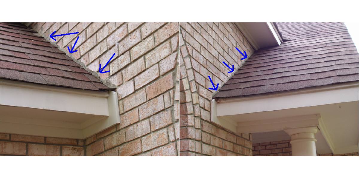

Scottpat Posted September 11, 2004 Report Share Posted September 11, 2004 I never see lintels on gable walls. The brick is always sitting on a a beam. It's getting to the point that I seldom see any flashing. I can't tell you how many homes I find with the shingles tucked into the mortar. Example: Download Attachment: No flashing.JPG 106.49 KB Link to comment Share on other sites More sharing options...

kteitel Posted September 18, 2004 Author Report Share Posted September 18, 2004 And now the rest of the story, I drove by the house today and one side of the roof has a piece of copper copper installed cut to look like step flashing but not woven into the shingles. The other side does not have the copper installed yet and there is NO flashing at all, just the shingles bent up slightly to act as a sort of flashing with a lot of tar. It's truely sad to see work like this on a new house. Thanks for everyones help. Kevin Link to comment Share on other sites More sharing options...
