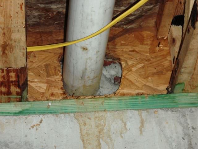

Bryan Posted October 28, 2009 Author Report Share Posted October 28, 2009 Here is a photo of a through wall penetration that is not flashed or sealed to the exterior sheathing. What really has me intrigued about this is there was a dark spot on the floor below the clothes dryer that started at the band board and went inward. The spot tested about slightly wetter than the surrounding sub-floor materials. The homeowners, for whom I am working, indicated that the washer has never overflowed, and the stain is adjacent to the washer, not below it. What I am speculating is happening is moisture is penetrating the masonry veneer, running down the back side of the veneer or the sheathing, following the dryer vent into the wall cavity, then sinking to the sub-floor. Given the visible penetration of the HVAC exhaust it appears that exterior wall penetrations were not sealed to the water resistant sheeting. Also if you look at the photo you can see where water has made its way in at the HVAC exhaust. Bryan Click to Enlarge 53.05 KB Quote Link to comment Share on other sites More sharing options...
Brandon Whitmore Posted October 28, 2009 Report Share Posted October 28, 2009 Very true. Let me phase it a different way. How do you flash the head of a window or door when there is nothing to lap over the head flashing? The same would go for a pipe penetration. I have no idea what the manufacturers require, but I would let in flashing above windows, etc. With pipe penetrations, I would make sure that there is a trim block at all penetrations and let in flashing there as well. Quote Link to comment Share on other sites More sharing options...
Bryan Posted October 28, 2009 Author Report Share Posted October 28, 2009 Very true. Let me phase it a different way. How do you flash the head of a window or door when there is nothing to lap over the head flashing? The same would go for a pipe penetration. I have no idea what the manufacturers require, but I would let in flashing above windows, etc. With pipe penetrations, I would make sure that there is a trim block at all penetrations and let in flashing there as well. When you say "let in" are you referring to extending the flashing to the interior side of the sheathing? Cause that is the only way I see to keep the water out of the wall assembly. Bryan Quote Link to comment Share on other sites More sharing options...
