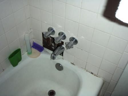

Bryan Posted November 12, 2009 Author Report Share Posted November 12, 2009 4 inch ceramic over 1970 drywall. Most of the grout in the units was shot. The attached photo is still an active shower, the tenants just did not feel like reporting the problem. I am just trying to back up a replacement reserve for complete surround replacement. Click to Enlarge 13.96 KB Bryan Quote Link to comment Share on other sites More sharing options...
Jim Katen Posted November 12, 2009 Report Share Posted November 12, 2009 4 inch ceramic over 1970 drywall. Most of the grout in the units was shot. The attached photo is still an active shower, the tenants just did not feel like reporting the problem. I am just trying to back up a replacement reserve for complete surround replacement. I installed tons of tile on 1970s drywall. It's got to be the worst way on earth to tile a surround. Woof! That's why I'm a home inspector - penance. Honestly, I'm surprised that a 1970 tile-over-drywall installation in a multi-family setting is still in sound condition. If I were doing a CNA, I'd slate them all for replacement as soon as possible. BTW, the Romans had bath surrounds that remained functional for hundreds of years. Some of them are still around, though I doubt that they're functional. But that's only because the Romans didn't keep up with their replacement reserve commitments. Quote Link to comment Share on other sites More sharing options...
kurt Posted November 12, 2009 Report Share Posted November 12, 2009 4 inch ceramic over 1970 drywall. Bryan That's not hard; they're already gone. Surprisingly, they go about 20-25 years. In rental property, folks live with the nastiness for about 5 years before it totally disintegrates. Quote Link to comment Share on other sites More sharing options...
