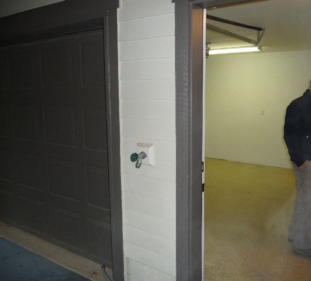

Richard Moore Posted December 15, 2009 Report Share Posted December 15, 2009 I occasionally have to write up hose bibs on exterior, unheated garage walls at new homes that lack interior shut-offs to drain the lines. Code seems a little "fuzzy" on these, but it seems like an obvious "best practices" issue. Today's new townhouse seemed worse than normal. The hose bib was at a short 18" wall between the car and man door. Presumably the piping (CPVC if it's the same as elsewhere) is coming from above. With the small size of the wall and three sides effectively exposed to the weather, this seems like a flood just waiting to happen if we get a long deep freeze. I'm actually surprised it survived the one that just ended. You guys write these up, right? Download Attachment: 091214B021.jpg 65.88 KB Link to comment Share on other sites More sharing options...
mgbinspect Posted December 15, 2009 Report Share Posted December 15, 2009 I added a line in my reporting system to identify "freeze vulnerable" pipes and fixtures about two year ago. I wish I could say it was the result of a miraculuous revelation from above, but I noticed it as a line item on another reporting system. That's why we're all here isn't it - to share and learn? It's a great warning for our clients that may save them an expensive lesson. Link to comment Share on other sites More sharing options...
kurt Posted December 15, 2009 Report Share Posted December 15, 2009 All the time, although the one's I see are usually on townhomes. Around here, I write up any pipe on an exterior wall if I'm lucky enough to be able to see it. Link to comment Share on other sites More sharing options...

Brandon Whitmore Posted December 15, 2009 Report Share Posted December 15, 2009 I have a buddy with a fire/ water restoration company. They had about 20 new jobs from the freeze we just went through. He said over half of them were from frozen pipes that run through garage attic spaces and travel over to exterior garage wall hose bibs. The installation of the year award goes to all of the plumbers who install a frost free hose bib on an unheated exterior garage wall to somehow get around having to install a shut off valve elsewhere. Link to comment Share on other sites More sharing options...
