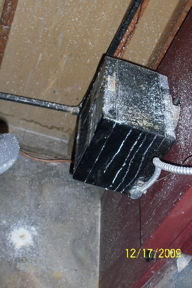

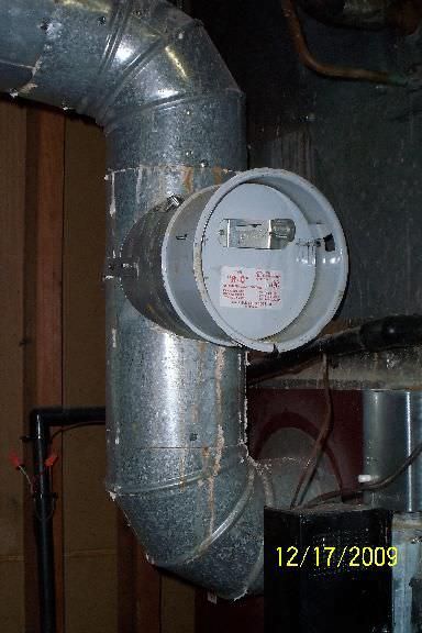

mgbinspect Posted December 18, 2009 Report Share Posted December 18, 2009 The photos below are of an exhaust system for a 1966 oil-fired furnace Of course I wrote it up as a suspected oil-burner adjustment problem and called for the works. I'm curious what is causing this peculiar type of residue and leaching. I know that H20 is a big biproduct of natural gas exhaust, but I wasn't as sure about fuel oil. Could it be a restricted flue? Thought maybe someone will recognize this specific condition. Thanks in advance. Mike Click to Enlarge 42.19 KB Click to Enlarge 56 KB Link to comment Share on other sites More sharing options...
randynavarro Posted December 18, 2009 Report Share Posted December 18, 2009 I see that frequently, although more so on gas units than oil-fired. It's the corrosive particulate from the metal flue oozing down and out of the seams 'cuz the exhaust is condensing too quickly. If you do a bit of searching on this site, there have been at least a few discussions. Link to comment Share on other sites More sharing options...
Bill Kibbel Posted December 18, 2009 Report Share Posted December 18, 2009 I know that H20 is a big biproduct of natural gas exhaust, but I wasn't as sure about fuel oil.H20 is a byproduct of combustion. You ever notice water dripping out of vehicle exhaust pipes? You probably don't see it there as often as with gas because oil burners operate at a lower combustion efficiency. I see it quite often as I inspect a lot of buildings that have been converted to oil heat when the chimney was designed and sized for coal. Coal heat kept chimneys warmer and didn't have rapid on/off cycles. With oil, these chimney flues are now at a lower temp., resulting in significant (and very acidic) condensation. Was the flue oversized? unlined? Chimney on the exterior of the building? Link to comment Share on other sites More sharing options...
mgbinspect Posted December 18, 2009 Author Report Share Posted December 18, 2009 It's 8" diameter with a few feet of horizontal before hooking up with a masonry chimney (9 X 13) so I suppose it cools down darn fast. It was just odd for an oil-burner around here - especially at every joint and hole. And, yes, Bill, the chimney is on the rear exterior wall - the NW wall, at that - never sees the sun. Link to comment Share on other sites More sharing options...
