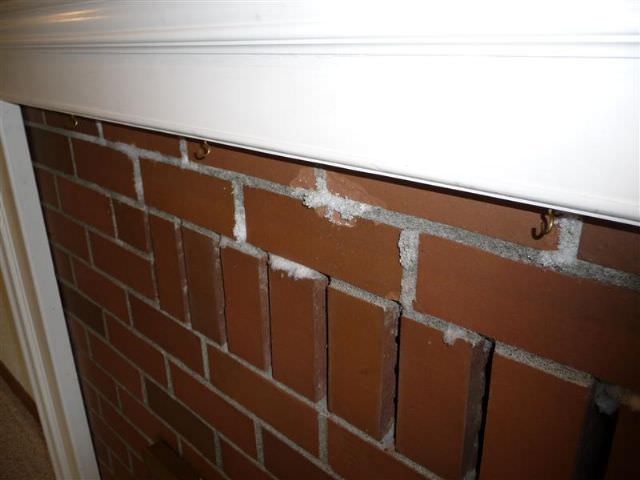

Robert Jones Posted March 26, 2010 Report Share Posted March 26, 2010 My first time seeing this. Home built in 1983. The stack, concrete cap and rain hat are all in good shape. The interior bricks have efflorescence showing. The fireplace does have a heatilator. What would cause this on the interior brick? Click to Enlarge 33.25 KB Click to Enlarge 81.14 KB Quote Link to comment Share on other sites More sharing options...
AHI in AR Posted March 26, 2010 Report Share Posted March 26, 2010 My money is on seepage through the brick...even if it looks OK. Especially if the joints are raked, not tooled. Could also be poor flashing details. Quote Link to comment Share on other sites More sharing options...
hausdok Posted March 26, 2010 Report Share Posted March 26, 2010 Hi Rob, Did you sound that crown to determine if it's fully adhered or did you just do a visual on it? How was the mortar where the counter flashings are let into the stack? Were there a set of shoulders on that stack that might have loose/cracked caps? ONE TEAM - ONE FIGHT!!! Mike Quote Link to comment Share on other sites More sharing options...
Robert Jones Posted March 26, 2010 Author Report Share Posted March 26, 2010 Thanks guys, It looks to me like the crown and flashing were replaced when the roof was replaced, approx 5 yrs or so ago. I have added another pic to my original post. There was no water staining etc... to the interior ceiling. The damper was a rusted, which is not to uncommon for 26 yrs. Quote Link to comment Share on other sites More sharing options...
randynavarro Posted March 26, 2010 Report Share Posted March 26, 2010 There's the fact that cap most assuredly hasn't been on the flue for the last 26 years. . . Quote Link to comment Share on other sites More sharing options...
Richard Moore Posted March 26, 2010 Report Share Posted March 26, 2010 Also...that reverse corbelling is stupid and sort of defeats the purpose of the mortar cap. Quote Link to comment Share on other sites More sharing options...
