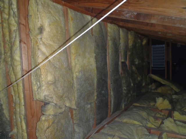

big dodo Posted June 4, 2010 Report Share Posted June 4, 2010 hello everyone im new to this site and i just wanted to start of by introduceing myself im hector from southern california. my dilema as of today starts at the attic. i am planning to install a roof vent along with intake openings at the eaves because my house has no openings at all.[:-bigeyes well my problem is this:half my house has a cathedral ceiling and the other has attic space. i was planning on putting a ridge vent all the way through both ceilings attic/cathdral. on the cathedral side can i get away with just opening the intake vent at the eaves? or do i need to take the drywall off and install baffles all along the rafters? the reason i say this is, because i had a section of drywall that was sagging a bit and when i removed it there was what looked like rot or termite damage what you guys think?? another question...im not sure but i think i have a bit of mold on the attic insulation is there a remedy for that? Click to Enlarge 31.7 KB Click to Enlarge 46.52 KB Quote Link to comment Share on other sites More sharing options...
hausdok Posted June 4, 2010 Report Share Posted June 4, 2010 Hi, Your rafters and roof deck are rotten. Now you know why proper ventilation is important. Get a competent contractor out there to strip the roof, replace the rotting components, treat what's left with a borate based fungicide, redeck it - this time with proper ventilation - and then reroof it. Do not try to shortcut the process or you'll be doing it again in a few years. ONE TEAM - ONE FIGHT!!! Mike Quote Link to comment Share on other sites More sharing options...
Ben H Posted June 4, 2010 Report Share Posted June 4, 2010 Hi, Your rafters and roof deck are rotten. Now you know why proper ventilation is important. Get a competent contractor out there to strip the roof, replace the rotting components, treat what's left with a borate based fungicide, redeck it - this time with proper ventilation - and then reroof it. Do not try to shortcut the process or you'll be doing it again in a few years. ONE TEAM - ONE FIGHT!!! Mike That pretty much sums it up. Quote Link to comment Share on other sites More sharing options...

big dodo Posted June 4, 2010 Author Report Share Posted June 4, 2010 Hi, Your rafters and roof deck are rotten. Now you know why proper ventilation is important. Get a competent contractor out there to strip the roof, replace the rotting components, treat what's left with a borate based fungicide, redeck it - this time with proper ventilation - and then reroof it. Do not try to shortcut the process or you'll be doing it again in a few years. ONE TEAM - ONE FIGHT!!! Mike well that sucks!! [:-weepn]so you are telling me i have to remove shingles, plywood and possibly ridge beam if rotted?...i wasnt planning on a complete re-roof at this time, rather i wanted to remove drywall off the cathedral ceilings and add ventilation and treat the rotted wood from underneath. and since there are 3 rooms with cathedral ceilings living room, dining room, bedroom, im just trying to contain it or keep it from spreading.(if possible) i dont have the funds to do everything at this point,just looking at my options. Quote Link to comment Share on other sites More sharing options...

hausdok Posted June 4, 2010 Report Share Posted June 4, 2010 Hi, Your rafters and roof deck are rotten. Now you know why proper ventilation is important. Get a competent contractor out there to strip the roof, replace the rotting components, treat what's left with a borate based fungicide, redeck it - this time with proper ventilation - and then reroof it. Do not try to shortcut the process or you'll be doing it again in a few years. ONE TEAM - ONE FIGHT!!! Mike well that sucks!! [:-weepn]so you are telling me i have to remove shingles, plywood and possibly ridge beam if rotted?...i wasnt planning on a complete re-roof at this time, rather i wanted to remove drywall off the cathedral ceilings and add ventilation and treat the rotted wood from underneath. and since there are 3 rooms with cathedral ceilings living room, dining room, bedroom, im just trying to contain it or keep it from spreading.(if possible) i dont have the funds to do everything at this point,just looking at my options. Your roof is rotting and you have no way to know how far incipient rot spore has spread. You can kill the existing spore and make the framing non-viable by drilling and inserting Impel rods in every single framing member throughout the entire roof and sister the severely rot-damaged ones with new lumber (which will also need to have Impel rods installed) and fix the ventilation, but your roof will not have the strength it was designed to have and you'll have to advise any buyers in a seller's disclosure form that the framing in the roof is a bunch of rotting sistered wood that's been treated with a fungicide. That's liable to scare a bunch of folks off. Do it once; do it right the first time. ONE TEAM - ONE FIGHT!!! Mike Quote Link to comment Share on other sites More sharing options...
