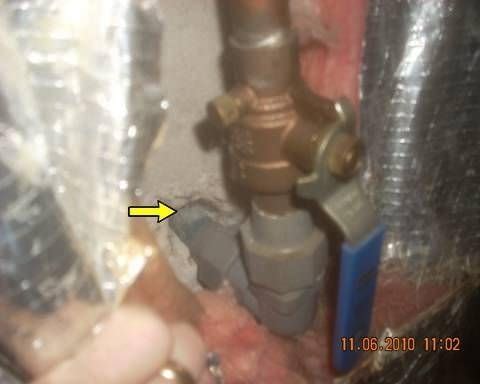

Water supply line -- is it polybutylene?
meddle
What is this, the week for Acetal service fittings.
Check recent threads. There have been two others posting the exact same thing earlier this week.
That's an acetal fitting.
Commonly used with PB pipe.
Some of the PB service pipes were *not* part of the recall and seem to be fine.
You won't know without exposing a foot or two of pipe and reading the number.
- Jim Katen, Oregon
