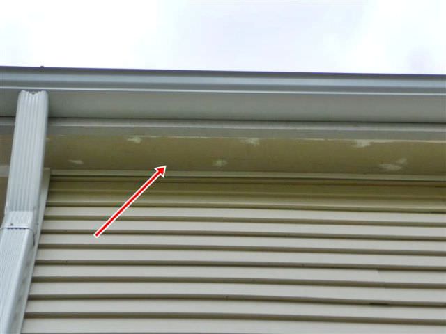

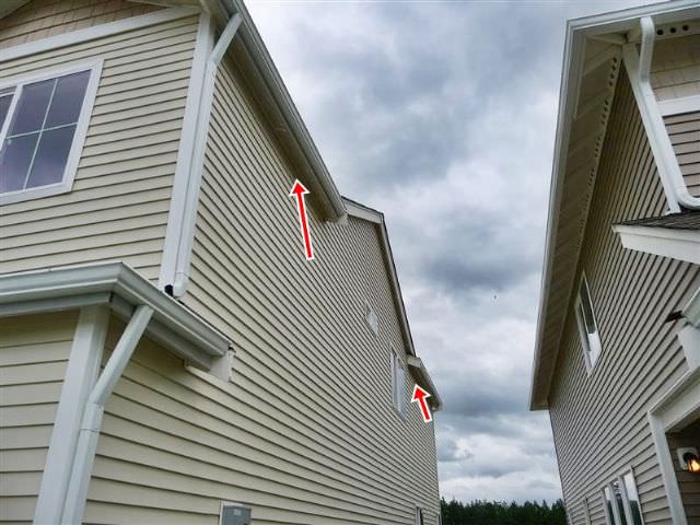

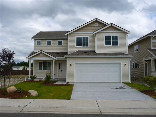

Robert Jones Posted June 28, 2010 Report Share Posted June 28, 2010 New construction home. Soffit vents on the north facing side of the home. Roof vents on the south side of the home. One small gable end vent on the west facing side of the home. For some reason, the soffit vents on the south side of the home have been covered up. Am I missing something? I don't think is allows for sufficient ventilation of the attic cavity. Just can't figure out why the soffit(s) were boarded over. Click to Enlarge 34.92 KB Click to Enlarge 69.76 KB Click to Enlarge 50.69 KB Quote Link to comment Share on other sites More sharing options...

Robert Jones Posted June 29, 2010 Author Report Share Posted June 29, 2010 Hey Marc, The typical venting requirements here are 1/150. There is no cavity above the garage, however, it does have soffit vents running along the front edge. This is a bank owned special that didn't even have insulation in the attic cavity! And people think that new construction homes don't need inspections. I hear people over and over again say, "but the county inspected it, right". Quote Link to comment Share on other sites More sharing options...

Rocon Posted June 29, 2010 Report Share Posted June 29, 2010 The only thing I can think of is if the south facing rake was (lets say) 2x 12 with drywall attached to the underneath side, the bays may not be ventilated. Were the bedroom ceilings vaulted? Quote Link to comment Share on other sites More sharing options...

Rocon Posted June 29, 2010 Report Share Posted June 29, 2010 You would have mentioned spray foam insulation in the attic, so... Then the only thing I can think of is if someone read an article about venting that suggested that soffit vents on the south exposure will allow hot air into the vents. So they put all the vents on "cooler sides" of the building. If you draw in cooler air then you have greater cooling ability. But that is supposition on my part wondering what someone did. So your fall back is the 1/150 venting rule. Does it have enough on the other sideââ¬â¢s or not? Mention that it is out of normal standard building practices. Let the builder explain what he did. Quote Link to comment Share on other sites More sharing options...

hausdok Posted June 29, 2010 Report Share Posted June 29, 2010 Hi, The only possible explanation is that osmeone is a moron. They need to add venting to that soffit. The gable end vent is going to trouble. It won't show up now but it will years from now when some home inspector goes up in there and finds the underside of the roof all covered with fungi and explains that a gable end vent will short circuit the proper flow of air from the eaves to the ridge. ONE TEAM - ONE FIGHT!!! Mike Quote Link to comment Share on other sites More sharing options...
