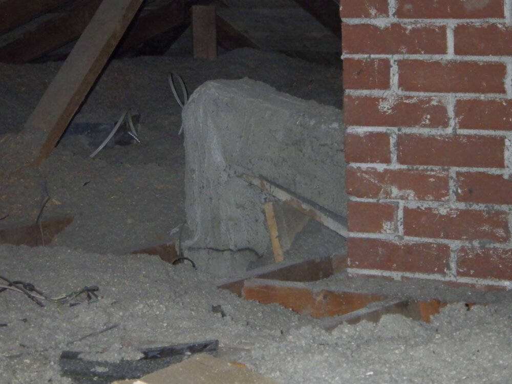

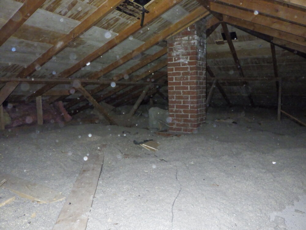

This 1940's home had the original brick chimney with 'terra-cotta liner'. Only a furnace and water heater using the chimney now - separate issues. What I am curious about is this 'side-elbow'. Any thought would be appreciated.

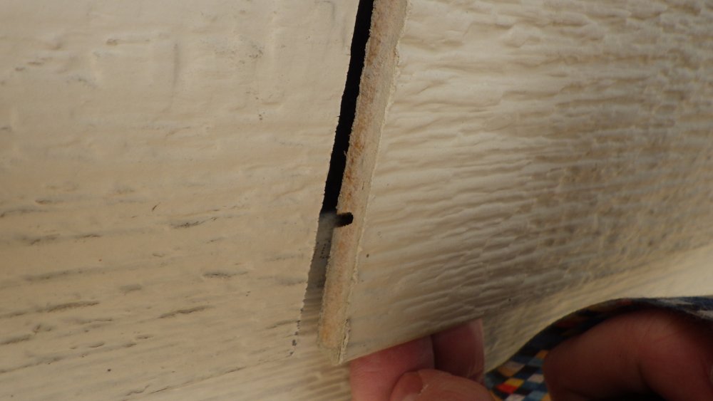

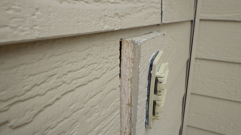

Thanks Jim, I believe it is a Masonite or similar hardboard product. I'm just surprised to a find a 35 year old installation that looked so good .
Looking for an ID please. 1985 home in Calgary and the siding looked great. All aluminum corners in place, all most all butt joints covers in place. I see a groove in the back of the (what I assume to be ) hardboard that is unlike anything I am familiar with. but then I see the cross section of the "blocks" at a telephone jack and older electrical cover plate and think it could be newer materials.
