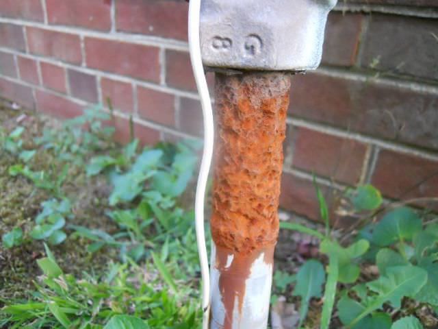

mgbinspect Posted September 9, 2010 Report Share Posted September 9, 2010 Does anyone know for sure - is it plastic gas line or is it just a jacket over something a bit tougher than plastic. Every time I've looked closely to a gas line as it comes out of the ground, I can't make heads or tails of what the material really is. It almost looks and feels a bit like lead, but I know that can't be the case. And I've also seen the surface oddly corroded. So, what is it? Quote Link to comment Share on other sites More sharing options...
Jim Katen Posted September 9, 2010 Report Share Posted September 9, 2010 Does anyone know for sure - is it plastic gas line or is it just a jacket over something a bit tougher than plastic. Every time I've looked closely to a gas line as it comes out of the ground, I can't make heads or tails of what the material really is. It almost looks and feels a bit like lead, but I know that can't be the case. And I've also seen the surface oddly corroded. So, what is it? What I see around here is an epoxy coated steel riser that comes out of the ground. Underground, it transitions to a flexible plastic pipe. I'm sure that there are several different versions. Quote Link to comment Share on other sites More sharing options...
mgbinspect Posted September 9, 2010 Report Share Posted September 9, 2010 Does anyone know for sure - is it plastic gas line or is it just a jacket over something a bit tougher than plastic. Every time I've looked closely to a gas line as it comes out of the ground, I can't make heads or tails of what the material really is. It almost looks and feels a bit like lead, but I know that can't be the case. And I've also seen the surface oddly corroded. So, what is it? What I see around here is an epoxy coated steel riser that comes out of the ground. Underground, it transitions to a flexible plastic pipe. I'm sure that there are several different versions. That would have been one of my guesses - some form of epoxy. I never realized, though, that buried gas lines were actually plastic. I feel a lot less comfortable with the idea of plastic gas lines than plastic water lines. It sounds so fragile (hopefully they're some pretty beefy plastic lines or reinforced somehow. It just sounds so fragile... BTW. here's an example of the odd corrosion (or deterioration may be a better word), I was bringing up: Click to Enlarge 49.61 KB I saw this on an inspection last week. Strange stuff, eh? Certainly that's not rust. It's probably some other protective surface gone bad. Maybe it's just been dinged up by a weed eater. I just told them to notify the local gas company that something didn't seem right - no leaks, just a bit of concern. Quote Link to comment Share on other sites More sharing options...
John Dirks Jr Posted September 9, 2010 Author Report Share Posted September 9, 2010 Does anyone know for sure - is it plastic gas line or is it just a jacket over something a bit tougher than plastic. Every time I've looked closely to a gas line as it comes out of the ground, I can't make heads or tails of what the material really is. It almost looks and feels a bit like lead, but I know that can't be the case. And I've also seen the surface oddly corroded. So, what is it? What I see around here is an epoxy coated steel riser that comes out of the ground. Underground, it transitions to a flexible plastic pipe. I'm sure that there are several different versions. That would have been one of my guesses - some form of epoxy. I never realized, though, that buried gas lines were actually plastic. I feel a lot less comfortable with the idea of plastic gas lines than plastic water lines. It sounds so fragile (hopefully they're some pretty beefy plastic lines or reinforced somehow. It just sounds so fragile... BTW. here's an example of the odd corrosion (or deterioration may be a better word), I was bringing up: Click to Enlarge 49.61 KB I saw this on an inspection last week. Strange stuff, eh? Certainly that's not rust. It's probably some other protective surface gone bad. Maybe it's just been dinged up by a weed eater. I just told them to notify the local gas company that something didn't seem right - no leaks, just a bit of concern. Looks like rust to me. Maybe a rusting clamp/collar or whatever its called. Look at the first pic in post #1. There's a collar of sorts where the pipe transitions into the meter base. Quote Link to comment Share on other sites More sharing options...
