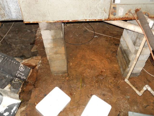

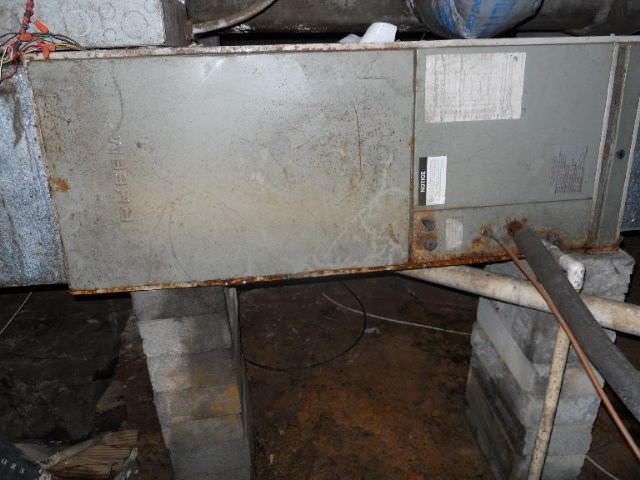

mgbinspect Posted September 16, 2010 Report Share Posted September 16, 2010 This morning I received a call from a frantic client of mine. He has a foreclosre property under contract. I performed his inspection, and called for the heat pump air handler to be replaced, cautioning that in most cases the HVAC contractor will insist that both units must be replaced. The Bank agreed to replace the air handler. The HVAC contractor arrived to do the work and called the listing agent to inform him that the unit was fine. He followed that up with a letter stating that the unit was not compromised in any way. Here, for educational purposes and general discussion, is my response in writing to all parties involved: To Whom It May Concern: Please examine the attached photos of the heat pump air handling unit, located in the crawlspace. Notice the following conditions visible and apparent in Photo 103: Click to Enlarge 53.72 KB The entire bottom of the air handler cabinet is rusting and corroding. (Rest assured that the interior of this unit looks much worse that the outside of the unit.) The rust is heaviest at the left end of the evaporator coil housing that is farthest from the drain lines for the internal drip tray. It appears that the drip tray has probably rusted through at some location. The entire unit sags downward immediately after leaving the support blocks, apparently due to metal fatigue (rust). The left stack of support blocks is wet from water leaking from the unit. Water drips from the bottom of the air handling unit - the end where the blower is. This means that the component that moves the air through the home is wet and has been wet for a long period of time. Moisture should never get into the air handling side of a unit or the adjoining ductwork, as it produces conditions favorable for fungal growth. When the unit is replaced, thoroughly inspect all the adjoining ductwork, and remove and replace any portion that displays evidence of ever having been wet. Notice the following visible and apparent condition in photo 104: Click to Enlarge 62.98 KB The earth directly below the blower end of the air handler is saturated and water is ponding. (Water was literally dripping from the bottom left end of the air handler on the day of the inspection. It was witnessed by both this inspector the purchaser.) Notice the following visible and apparent condions in photo 106: Click to Enlarge 55.55 KB Heavy rust and unidentified debris covers the drip tray under the evaporator coil. While some dampness is present, water is obviously not collecting in the drip tray, to drain out through the drain line. It seems apparent that the drip tray is rusted through at some location and the condensate is running along the inside of the air handler cabinet to drain out of the blower end of the unit. It is rare for me to call for an HVAC unit to be replaced, but if I were purchasing this home, I would not accept this air handler unit. There are too many reasons, why it poses both a health and financial risk. This is why it was called to be replaced in the home inpsection report. Do call if you have further questions or concerns. Respectfully yours, Michael G. Bryan President MGB Inspection Services 804-744-0380 "This above all; to thine own self be true!" - Shakespeare Quote Link to comment Share on other sites More sharing options...

Terence McCann Posted September 16, 2010 Report Share Posted September 16, 2010 Did the listing agent get to choose the repair company? I wouldn't loose sleep over it Mike - looks like most pos units that haven't had maintenance in decades. A car with four flat tires can still move forward although I wouldn't recommend (or is that consider) driving it. Here's my report - have a nice day. Quote Link to comment Share on other sites More sharing options...
mgbinspect Posted September 16, 2010 Author Report Share Posted September 16, 2010 Did the listing agent get to choose the repair company? I wouldn't loose sleep over it Mike - looks like most pos units that haven't had maintenance in decades. A car with four flat tires can still move forward although I wouldn't recommend (or is that consider) driving it. Here's my report - have a nice day. I never was worried. It's not that often I call for total replacement, unless it's toast. So, I already knew before I pulled up the pics that I wasn't about to back-peddle. I wrote the letter because everyone was suddenly on tilt, twenty-eight hours before closing. The HVAC contractor was from a town over an hour and a half away (good call Terence). So I figured I'd pull his pants down with these no-brainer pics and explanations, so everyone is clear on why it ain't closin' tomorrow... Quote Link to comment Share on other sites More sharing options...

Marc Posted September 17, 2010 Report Share Posted September 17, 2010 I recognize that brand and model in the photo as nearly identical to my own AC which I replaced 3 years ago. Exact same issues with the condensation getting in the wrong place and rusting the housing to the point of collapse. It also shorted out the incoming 240V supply and spread the stench of burning wire insulation throughout the house. I'm glad that you stood your ground Mike but I also agree with John Baine - I wouldn't have bothered with the letter. That contractor wasn't worth half the trouble. Marc Quote Link to comment Share on other sites More sharing options...

mgbinspect Posted September 17, 2010 Author Report Share Posted September 17, 2010 I think the letter probably did your reputation a whole lot of good. The client, realtor, banker, and the contractor had documented proof that you were the only one who had done his job. Without it, it's your word against his and that might have left some doubting you. None of them will forget it. I was angry that some sociopathic contractor was ready, willing and trying to let my client be stuck with a played out heat pump they'd be replacing the next time is was serviced by a competent tech. To steal a little of the thunder from another thread out there right now, my findings were being disputed, by an alleged "qualified", "licensed" and "reputable" contractor? So, I figured the thing to do was remove all doubt and demonstrate that he wasn't any one of the three. Quote Link to comment Share on other sites More sharing options...
