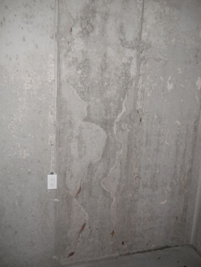

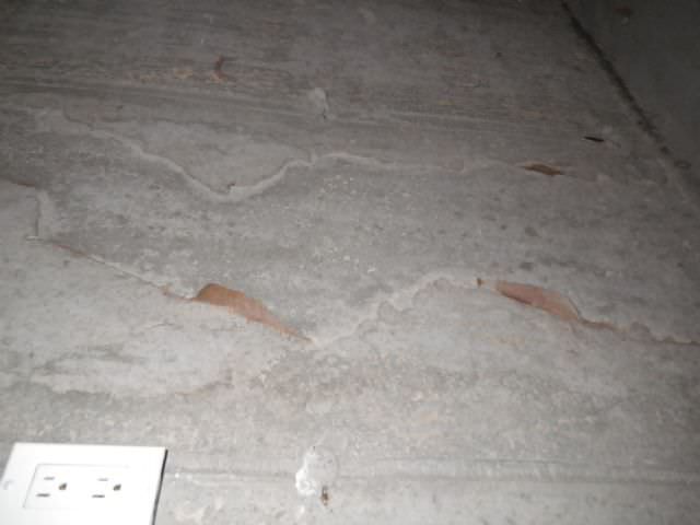

mheeley Posted October 4, 2010 Report Share Posted October 4, 2010 Hello, I came across this today and I'm not a 100% sure what it is. It looks a little like a cold pour but there is brown paper coming out of the edges of the joints between the two different colored surfaces. The concrete was fine and felt solid. Click to Enlarge 54.05 KB Click to Enlarge 34.44 KB The client had questions about it and I didn't have a solid answer. Any help would be appreciated. Cheers, Mike Quote Link to comment Share on other sites More sharing options...
kurt Posted October 5, 2010 Report Share Posted October 5, 2010 Kind of hard to tell, but it's kind of like a cold line. Except, this one has paper coming out of it. That's quite odd. Do they line forms with paper in your area? Quote Link to comment Share on other sites More sharing options...

Jerry Simon Posted October 5, 2010 Report Share Posted October 5, 2010 Nope, not a cold pour. The lines/shapes/colors/cardboard(?) are from the forms. I stripped tens-of-thousands of such forms in another life. Perhaps from a minimal/poor form-oiling job. Client ain't got no need to fret. Quote Link to comment Share on other sites More sharing options...

Tom Raymond Posted October 5, 2010 Report Share Posted October 5, 2010 So the paper was on the form? My first thought was an additive of some kind. Many of them, like color or fiber, come in bags that are designed to be tossed into the mixer drum. I could see how some paper could survive to end up in the wall like that. Quote Link to comment Share on other sites More sharing options...
