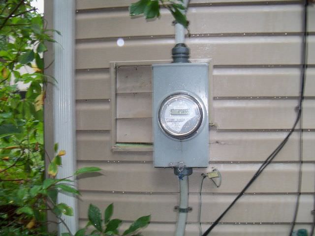

cbass Posted October 5, 2010 Report Share Posted October 5, 2010 I was at a house today, 33 year old, that had vinyl siding installed over metal siding (evident by the electric meter). What do you guys tell your clients when you encounter this? Quote Link to comment Share on other sites More sharing options...
Brandon Whitmore Posted October 5, 2010 Report Share Posted October 5, 2010 What do you guys tell your clients when you encounter this? Assuming that everything looks like it's in good shape and was well installed, I'd tell my client that it looks like they are well protected against moisture intrusion. Can't say I've ever seen vinyl installed over metal........... Quote Link to comment Share on other sites More sharing options...
cbass Posted October 5, 2010 Author Report Share Posted October 5, 2010 I have seen it before, but usually it is poorly installed (windows sunk in due to lack of clearance etc...). This time i wouldn't have even noticed except you could still see the metal behind the electric meter. Click to Enlarge 47.43 KB Water was following that communication wire on the right into the home and dripping inside the electrical panel! bzzzt! Quote Link to comment Share on other sites More sharing options...

Chad Fabry Posted October 15, 2010 Report Share Posted October 15, 2010 It doesn't look like vinyl over metal to me. It looks like it had aluminum siding and it was removed except from behind the meter and then the meter box was replaced with a smaller unit, exposing some of the old siding. Maybe it's the photo, but it looks like the metal and the vinyl are almost flush. Quote Link to comment Share on other sites More sharing options...
