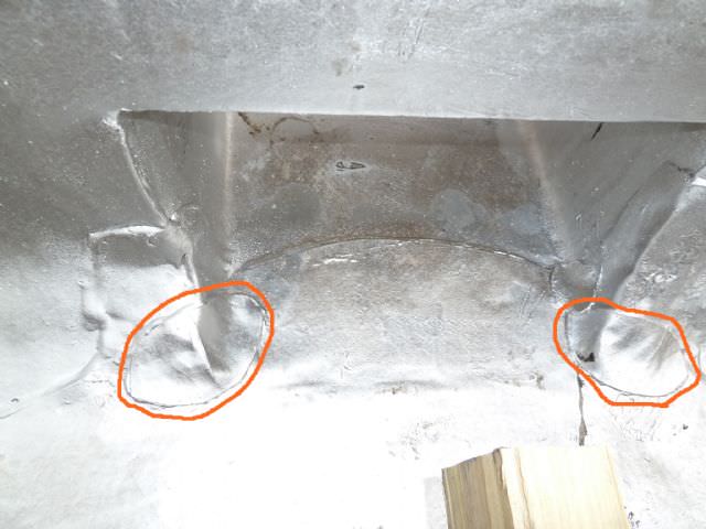

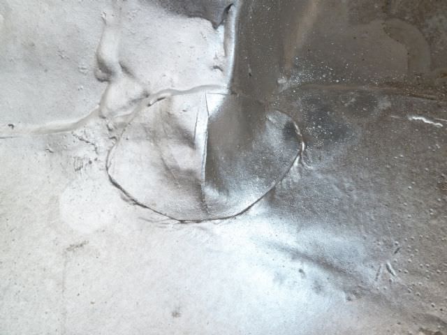

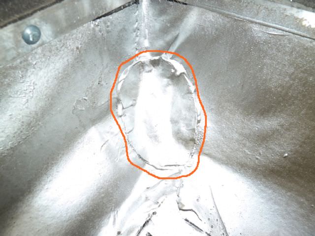

caryseidner Posted December 3, 2010 Report Share Posted December 3, 2010 I'm sure this is not news to many of you, but it might be helpful for the rest. These pictures show a necessary flashing detail for inside and outside corners, that I rarely see in residential work. We called them "footballs", but the hispanic roofers I worked with called them something else[:-censore. When the mod bit sheet is cut so it can be folded up to form an inside or outside corner, there is a vulnerable area at the apex of the cut. These patches cover that area and complete the flashing detail. When these are missing, I know that the roof was not installed by a trained mod bit roofer. Just thought I would share. Click to Enlarge 47.14 KB Click to Enlarge 53.31 KB Click to Enlarge 55.93 KB Link to comment Share on other sites More sharing options...

caryseidner Posted December 4, 2010 Author Report Share Posted December 4, 2010 Good stuff, Casey. Chevrons are also OK for inside and outside corners. Download Attachment: mod bit corner details.pdf 192.94 KB Yea Mack, those work too. Doesn't really matter what shape the patch is, so long as they are present. I think the guys liked the football shape because it was pretty easy to cut with a hook blade, and you could cut quite a few from scrap material. In your detail it looks like they actually "set" the granules into the sheet before apply the patch. "Setting" the granules is done by applying a little bit of heat to the mod bit, and then troweling over the granules so they get buried into the bitumen. This way the patch can be applied to a smooth surface instead of a micro-mountain terrain. This is another indicator of a trained roofer. Link to comment Share on other sites More sharing options...
