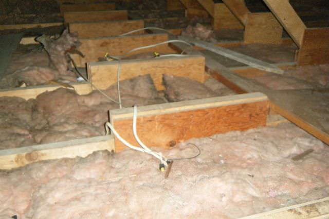

John Kogel Posted February 19, 2011 Report Share Posted February 19, 2011 Amateur installation. Could be hidden defects. No permit. Quote Link to comment Share on other sites More sharing options...
Brandon Whitmore Posted February 19, 2011 Author Report Share Posted February 19, 2011 Could be hidden defects There may be, but nobody was trying to hide anything on this one........ Click to Enlarge 43.23 KB Click to Enlarge 42.67 KB Quote Link to comment Share on other sites More sharing options...
