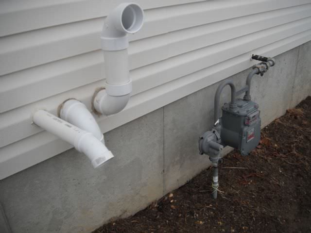

NJinspector Posted March 25, 2011 Report Share Posted March 25, 2011 I understand that the exhaust and intake can not be within four feet of the gas meter, but am just curious who goofed. New construction, what comes first? The meter or the furnace? Click to Enlarge 35.97 KB Link to comment Share on other sites More sharing options...

AHI in AR Posted March 25, 2011 Report Share Posted March 25, 2011 As a builder for 25 years, I can tell you that on my jobs there was usually some overlap between plumbers and HVAC guys on site. As far as scheduling the other trades, the electrician usually came after these trades since wiring is more easily made to work around ducts and plumbing lines than the other way around. That said, I was a low volume builder generally building only a few relatively larger custom homes. When you get to large scale builders, I suspect that anything goes. The almighty schedule rules. P.S. That intake and exhaust look suspect also. Link to comment Share on other sites More sharing options...
Brandon Whitmore Posted March 25, 2011 Report Share Posted March 25, 2011 P.S. That intake and exhaust look suspect also. According to the Vinyl Siding Institute, the siding penetrations are wrong as well...vinyl (page 24) You'd have to check with the actual siding manufacturer to see what they say. Link to comment Share on other sites More sharing options...
Scottpat Posted March 25, 2011 Report Share Posted March 25, 2011 95% chance that the meter was installed after the HVAC system was in place. They will not install the meter untill the final grading is done and that is usually one of the last things done to a home. Link to comment Share on other sites More sharing options...
Darren Posted March 25, 2011 Report Share Posted March 25, 2011 Yeah but, the piping in the house (and probably the underground too) was already installed. That interior piping had to be completed prior to a framing inspection. Blame the super or the builder for lack of coordination. Link to comment Share on other sites More sharing options...
John Kogel Posted March 25, 2011 Report Share Posted March 25, 2011 on another thread it was decided that the dinosaurs came first.[:-bigmout[:-banghea But as far as we know, they were hatched from eggs. [] The piping may have been in place, but the meter could have been installed to the right of the elbow. I'd blame the gas company. Link to comment Share on other sites More sharing options...
NJinspector Posted July 6, 2011 Author Report Share Posted July 6, 2011 I have come across this problem again and now getting feedback from the builder that I'm wrong, that the clearance is only 12" from meter. Can somebody provide the exact code for this ?? Link to comment Share on other sites More sharing options...
Garet Posted July 7, 2011 Report Share Posted July 7, 2011 Try contacting the engineering department of the local utility provider and ask if they have a document detailing installation requirements. Link to comment Share on other sites More sharing options...
