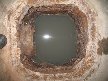

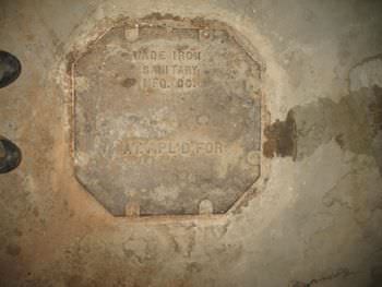

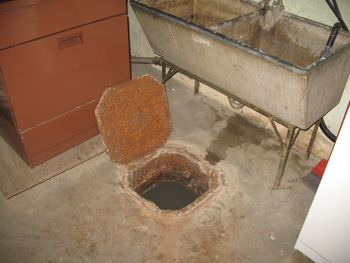

smarcus Posted May 12, 2011 Report Share Posted May 12, 2011 Found this pit in a basement in Chicago, the home was from the 30s. Water from the laundry tub flowed into it and I believe it then went to the sewer. There was a lite sewer gas odor throughout the basement that I believe was coming from this pit. I speculated that there was no trap. However, the smell was not stronger in any one location pretty consistent throughout the basement. In the photo directly above the pit water flowed in from a pipe at the right and out through a pipe to the left. I thought it might be a sediment trap when I was watching it, but can't think of a reason for a sediment trap in a home. Can anyone identify this? Click to Enlarge 16.26 KB Click to Enlarge 21.48 KB Click to Enlarge 16.3 KB Quote Link to comment Share on other sites More sharing options...
John Kogel Posted May 12, 2011 Report Share Posted May 12, 2011 That was then, this is now. I don't think that kind of thing is permitted nowadays, although I can't be sure what they would do with that in Chicago. I would recommend a drain company check the drainage and replace that pit with a continuous pipe. I'll bet some of that drain pipe is shot, so the little pit could escalate into a major PITA. Quote Link to comment Share on other sites More sharing options...
Bill Kibbel Posted May 14, 2011 Report Share Posted May 14, 2011 Wade was a big manufacturer of interceptors and separators. Interceptors were used for cooking grease and separators for drain systems (like in garages) that might have gas/oil. I'm pretty sure that is their separator. Quote Link to comment Share on other sites More sharing options...
kurt Posted May 14, 2011 Report Share Posted May 14, 2011 Kibbel, you're a spook....... It's the grease trap. Chicago had (has) lousy sewers. Everyone cooked with lard and dumped it down the drain. All soaps were animal fat based. All that grease clogged up the city sewers. So, grease traps were required from about 1900 to approximately 1989. All kitchen sink and laundry drains were routed through the grease trap (interceptor), the grease was separated out, and the clarified effluent ran down the outlet to joint the main building sewer. Sometimes they're in the back yard (most common), sometimes they're in the basement or garage (common on the NW side). Where was the house? Quote Link to comment Share on other sites More sharing options...
smarcus Posted May 14, 2011 Author Report Share Posted May 14, 2011 House was in Oak Park, IL. I first saw it I thought grease trap, but the in/out pipes were at the same elevation with no indication of separate chambers, so grease on top would just continue through the pit. At least that's what I thought I observed when watching it. Water in from the right then out through the left. Quote Link to comment Share on other sites More sharing options...
Jim Katen Posted May 14, 2011 Report Share Posted May 14, 2011 House was in Oak Park, IL. I first saw it I thought grease trap, but the in/out pipes were at the same elevation with no indication of separate chambers, so grease on top would just continue through the pit. At least that's what I thought I observed when watching it. Water in from the right then out through the left. We have similar separators in some of the older garages in Portland. They simply used an elbow at the outlet pipe to act as a baffle. Perhaps the outlet pipe in your picture once had an elbow that has since been removed. Quote Link to comment Share on other sites More sharing options...
kurt Posted May 14, 2011 Report Share Posted May 14, 2011 yeah, sometimes the outlet tee is removed by the guy that's rodding tree roots out of the sewer. Quote Link to comment Share on other sites More sharing options...

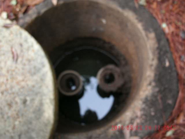

Phillip Posted May 14, 2011 Report Share Posted May 14, 2011 Y'all have me thinking this might have been something like you are talking about. I did not know what it is. It is out behind an older house. It is about 2 tiles deep. Click to Enlarge 32.48 KB Quote Link to comment Share on other sites More sharing options...
