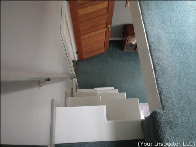

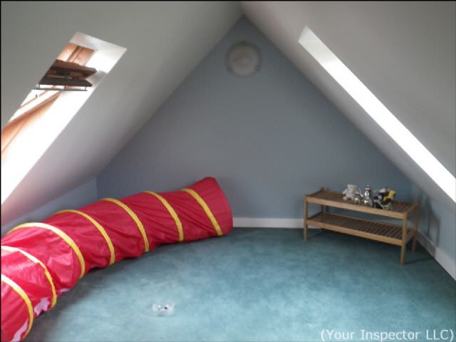

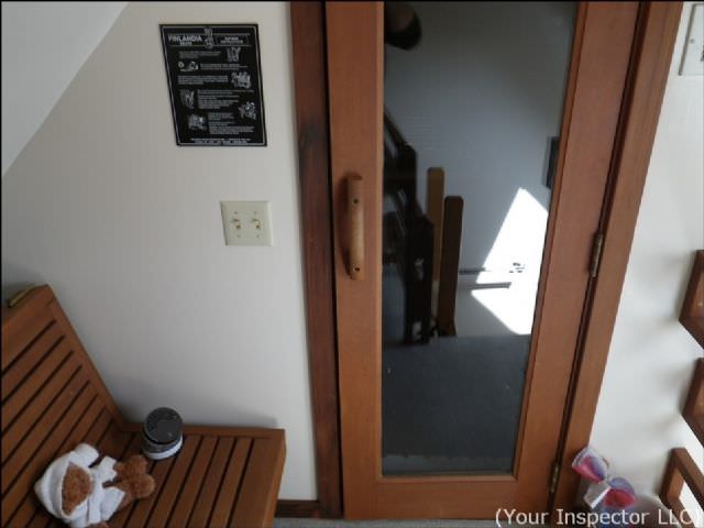

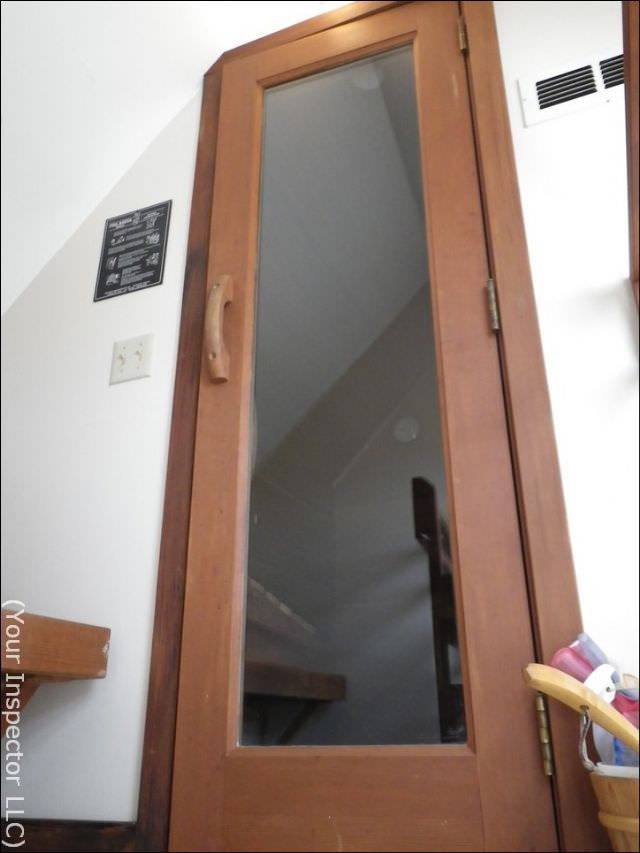

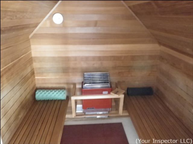

hausdok Posted May 15, 2011 Report Share Posted May 15, 2011 You guys will love this (NOT!!): 101-year old bungalow. The guy that lived there wanted a playroom for the kids and he wanted a sauna but there was nowhere to put them...except up in the attic (??!!!) Click to Enlarge 26.62 KB Click to Enlarge 54.76 KB Click to Enlarge 35.77 KB Click to Enlarge 37.3 KB Click to Enlarge 33.5 KB Click to Enlarge 33.11 KB Click to Enlarge 33.67 KB Click to Enlarge 50.15 KB Click to Enlarge 35.32 KB Click to Enlarge 36.91 KB Click to Enlarge 36.43 KB I suppose if you feel a little light-headed when you step out of this sauna that it would be a good idea to sit down and drink some fluids and get your senses back before attempting to climb back down this ladder. Steep roof. Just about wore me out getting up there and moving along that ridge. I'm not getting any younger. ONE TEAM - ONE FIGHT!!! Mike Link to comment Share on other sites More sharing options...
Tom Raymond Posted May 15, 2011 Report Share Posted May 15, 2011 I do like it, though the play room could use some gaurd rails. Around here the sauna would be superfluous. The attic would excede the sauna temps for at least half the year. Link to comment Share on other sites More sharing options...
kurt Posted May 15, 2011 Report Share Posted May 15, 2011 Anytime I see a ships ladder, I'm inclined to like the work. The only thing I'd change if it was mine would be a simple guardrail to prevent the ass end over teacup fall off the ledge. I kinda think if folks want to do something like this, let 'em do it. If someone wants to buy it, advise them of the obvious safety risks, and let 'em buy it. Anyone's ever lived on a boat confronts stuff much more dangerous than this. You live in it, you become attuned to the conditions. Link to comment Share on other sites More sharing options...
John Kogel Posted May 15, 2011 Report Share Posted May 15, 2011 I can accept a ladder with high handles, because you descend facing in the way you went up. No way I can accept that ridiculous staircase. Even hanging onto the handrail, facing out, you can spin around and loose it. It should be replaced with a ladder, IMO. Ask any Swede. The sauna is a little hut in the back yard, not in the house and certainly not up there. Maybe it's a copout, Mike, and this has been discussed before, but I will not crawl a 12 in 12 pitch roof. What did you see up there? Link to comment Share on other sites More sharing options...

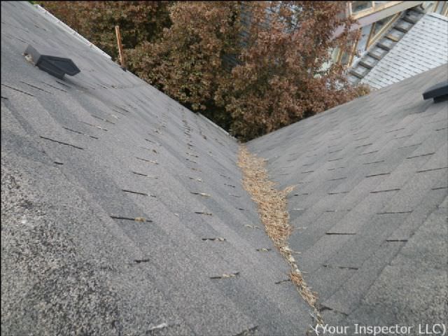

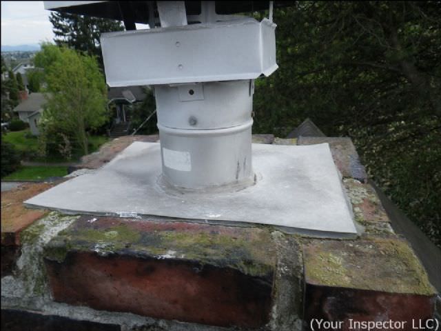

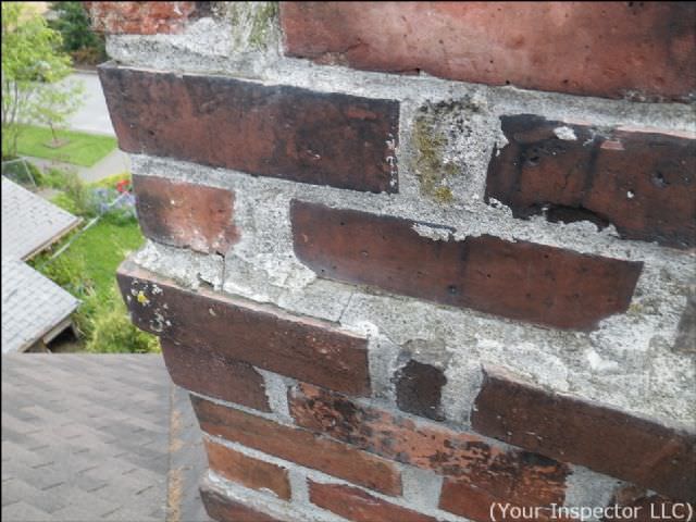

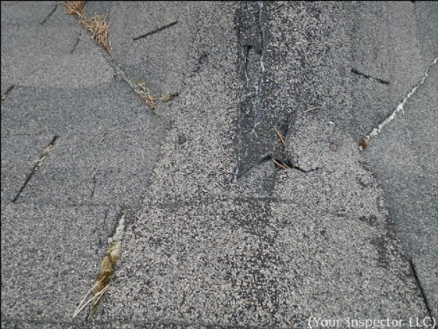

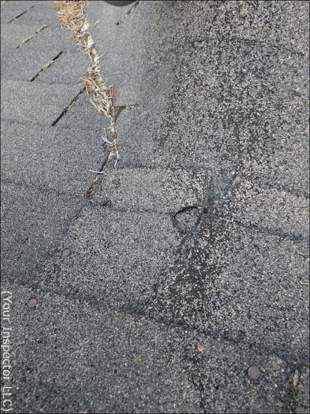

hausdok Posted May 15, 2011 Author Report Share Posted May 15, 2011 Maybe it's a copout, Mike, and this has been discussed before, but I will not crawl a 12 in 12 pitch roof. What did you see up there? I should have taken photos of the 270°view I had from that roof, the Olympics, the Cascades and Mt. Rainier all at the same time. Too bad he couldn't get the view from the house. What did I see? Sometimes one sees more, sometimes less. In this case, a little bit of damage done by some numbnuts who doesn't know how to stand on a roof, a chimneystack that's taking on water because it doesn't have a proper crown, some debris, some moss/algae, and some trees abrading the edges of the roof. All pretty educational for a homeowner that had no idea what the consequences of some things done and not done on a roof can be. Click to Enlarge 66.41 KB Click to Enlarge 51.65 KB Click to Enlarge 100.68 KB Click to Enlarge 199.54 KB Click to Enlarge 70.78 KB Click to Enlarge 65.99 KB Click to Enlarge 71.14 KB Click to Enlarge 48.67 KB ONE TEAM - ONE FIGHT!!! Mike Link to comment Share on other sites More sharing options...

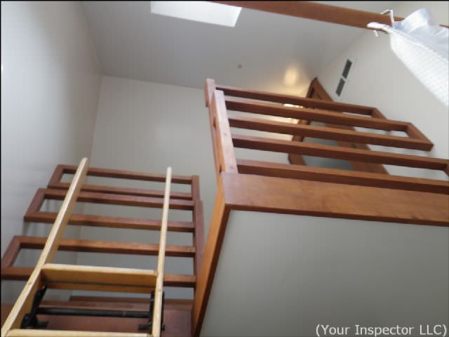

hausdok Posted May 15, 2011 Author Report Share Posted May 15, 2011 Originally posted by David Meiland In my perfect house, I'd have a fireman's pole from my BR to the kitchen, and a zip line from the 2nd fl. window to my garage roof. Hi Kurt, I actually like ship's ladders. What I took issue with here was the location of these. Look at the dearth of vents in picture #6 in the second set of photos. Tear off 3-4 decades of comp and a cedar shingle deck, slap a plywood deck on top and then shove a bunch of fiberglass tightly against the underside of a roof and then a bunch of drywall, without a means to dry out of the roof plane and what might you eventually get? ONE TEAM - ONE FIGHT!!! Mike Link to comment Share on other sites More sharing options...

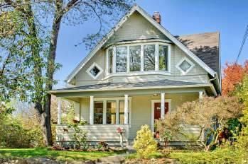

hausdok Posted May 15, 2011 Author Report Share Posted May 15, 2011 Jeez, I almost forgot. The house next door was a classic remuddler's dream. A small simple bungalow, 93 years old and less than 900 sf with a massive carbuncle of a contemporary addition cobbled onto the back. Click to Enlarge 65.05 KB ONE TEAM - ONE FIGHT!!! Mike Link to comment Share on other sites More sharing options...
