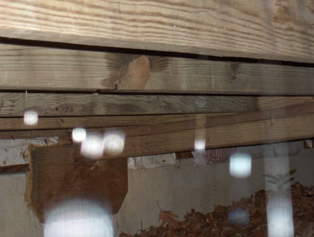

allseason Posted June 14, 2011 Report Share Posted June 14, 2011 Has anyone ever seen a deck beam support like this? I know the picture sucks but it may get the point across. It is a 2 inch thick plate that looks to be glued to the foundation and with three nails holding it to the house. It has a space cut out of the center as a beam pocket. There is no ledger on the house as the beam runs perpendicular to the house. The joists run parallel the the house and are sitting on a ledger on the beam. No movement of the deck noted, house is about 16 years old and the deck looks like original construction, but it doesn't look right, no visible bolts seen at the interior of the basement. I've never seen anything like this. Click to Enlarge 41.6 KBClick to Enlarge 40.73 KB Link to comment Share on other sites More sharing options...
Chad Fabry Posted June 14, 2011 Report Share Posted June 14, 2011 Fubar Link to comment Share on other sites More sharing options...
hausdok Posted June 14, 2011 Report Share Posted June 14, 2011 They might have epoxied it to the wall. Any sign that the plate was fitted over the end of a couple of rebar barbs, welded and then ground flat? If it's epoxy, the foundation will probably break before the epoxy joint will let go. Is the beam sized sufficient for the span and platform that it's carrying? ONE TEAM - ONE FIGHT!!! Mike Link to comment Share on other sites More sharing options...
Chad Fabry Posted June 14, 2011 Report Share Posted June 14, 2011 Mike, that's a block of wood that's glued on with construction adhesive. Link to comment Share on other sites More sharing options...
allseason Posted June 14, 2011 Author Report Share Posted June 14, 2011 Could be the rebar that I saw as the three fasteners, one on the bottom and one each at the upper portion to the sides of the beam pocket. Very low elevation of the deck made it tough to get close. Link to comment Share on other sites More sharing options...
hausdok Posted June 14, 2011 Report Share Posted June 14, 2011 OH Yeah, Now that I've enlarged it, I see what you're talking about. I thought it was a rusty piece of metal. Agree seriously FUBAR'd. ONE TEAM - ONE FIGHT!!! Mike Link to comment Share on other sites More sharing options...
allseason Posted June 14, 2011 Author Report Share Posted June 14, 2011 Yes, its wood, not metal. I don't understand why they did not just do a ledger on the house and move on from there. Nothing special, block foundation and wood frame construction. Looks like it needs redo. Link to comment Share on other sites More sharing options...
kurt Posted June 14, 2011 Report Share Posted June 14, 2011 Yes, redo. Anyone that'd do something that stupid probably has a few more "land mines" scattered around. I'd be on high alert. Link to comment Share on other sites More sharing options...

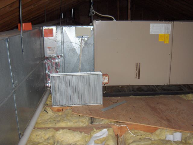

allseason Posted June 14, 2011 Author Report Share Posted June 14, 2011 I did see one other headscratcher. Two zone a/c with dampers at the blower in the attic. One themostat on the first floor and one on the second floor. House advertised as two zone cooling. One of the dampers was outside the duct, the hole covered with metal tape. The damper was still wired to the unit. Both thermostats are now running a single zone which is the entire house. I had to run up and down the stairs to check and see if the exposed damper would open, it didn't. Nothing else lacking from a structrural point if view. Click to Enlarge 39.5 KB Link to comment Share on other sites More sharing options...

Bain Posted June 15, 2011 Report Share Posted June 15, 2011 A system with dampers is not a two-zone system. As for the deck, the blocks of wood are canted because of the OSB, and the construction adhesive is applied on the WRB. I'm surprised the thrusts of the beams haven't popped the blocks off before now. Link to comment Share on other sites More sharing options...
allseason Posted June 15, 2011 Author Report Share Posted June 15, 2011 Originally posted by Bain A system with dampers is not a two-zone system. What would it be called? What defines a two zone system? Link to comment Share on other sites More sharing options...
