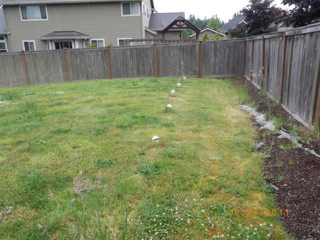

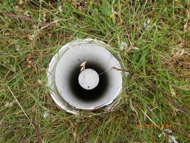

Robert Jones Posted June 28, 2011 Report Posted June 28, 2011 Anyone have an idea what this row of cleanouts are for? They were located at the back of the property near the fence. I was able to remove one of the caps and there is another smaller pipe inside. Home is on septic which is located at the front of the home. Lawn sprinkler system is installed. Click to Enlarge 78.21 KB Click to Enlarge 104.05 KB
Robert Jones Posted June 28, 2011 Author Report Posted June 28, 2011 I was thinking something to do with drainage, but it is deep in the back of the lot.
allseason Posted June 28, 2011 Report Posted June 28, 2011 Septic or municipal sewer? Septic fields wll have view ports built in. You can pull the cap and check for saturation.
Robert Jones Posted June 28, 2011 Author Report Posted June 28, 2011 The septic system was at the front of this home. Unless for some reason it was moved and this was left behind. Home is eight years old and in a development.
Bill Kibbel Posted June 28, 2011 Report Posted June 28, 2011 If they're 40" deep, they're groundwater monitoring wells. They are installed in relation to a septic system. It could be monitoring conditions for/from a septic system on an adjacent property.
Robert Jones Posted June 28, 2011 Author Report Posted June 28, 2011 Thanks Bill. That would make sense as there are homes on the side and back of the home I inspected. They are all on large lots with septic systems.
John Kogel Posted June 28, 2011 Report Posted June 28, 2011 My guess, but I wasn't there, is that the tank is at the front, but the pressurized field is there at the back. Each of those inspection ports would be at a branch line. Those systems use a small diameter drain pipe under pressure from a pump in the tank.
Steven Hockstein Posted June 28, 2011 Report Posted June 28, 2011 They are the air vents for the underground tunnel that leads to Control Headquarters. Look for the secret door in the basement of the house.
Kyle Kubs Posted October 25, 2011 Report Posted October 25, 2011 If they're 40" deep, they're groundwater monitoring wells. They are installed in relation to a septic system. It could be monitoring conditions for/from a septic system on an adjacent property. Sometimes they are monitoring wells the EPA puts in due to an oil tank leak. Most of those that I've seen have an embossed cap though, but not all.
