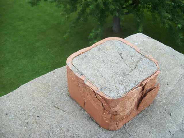

CoolSigns Posted July 7, 2011 Report Share Posted July 7, 2011 One chimney, two flues, one blocked off with cement? Click to Enlarge 67.82 KB left Click to Enlarge 63.22 KB right Click to Enlarge 65.04 KB Quote Link to comment Share on other sites More sharing options...
kurt Posted July 7, 2011 Report Share Posted July 7, 2011 It's a fake, the chimney is oversized to look baronial and expensive. At least, that's what I find when I see those around my 'hood. Quote Link to comment Share on other sites More sharing options...
Richard Moore Posted July 7, 2011 Report Share Posted July 7, 2011 Typically they would do that around here when one flue is no longer needed and they don't want rain and/or critters getting in. I don't mean to get on your case, but don't you think explaining to us what the house had in the way of fireplaces and/or gas or oil appliances would be helpful? Quote Link to comment Share on other sites More sharing options...
CoolSigns Posted July 7, 2011 Author Report Share Posted July 7, 2011 Typically they would do that around here when one flue is no longer needed and they don't want rain and/or critters getting in. I don't mean to get on your case, but don't you think explaining to us what the house had in the way of fireplaces and/or gas or oil appliances would be helpful? one fireplace uses wood, home built 1986...no other appliances using the chimney... Quote Link to comment Share on other sites More sharing options...

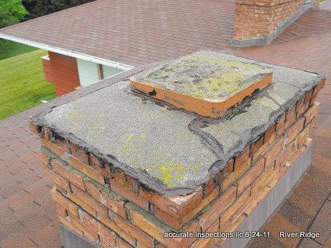

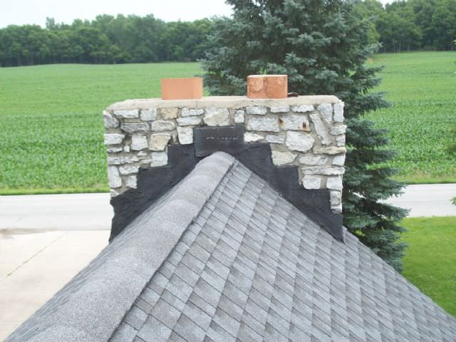

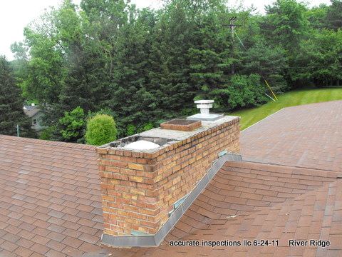

John Kogel Posted July 7, 2011 Report Share Posted July 7, 2011 Today's chimney, one flue, 3 dummys. The roofers should have built a cricket behind it. It was all about the looks of a massive brick erection, if that's the correct term. [] Oak trees are sacred in this burg, so cutting the tree down is verboten. Hey, there's my Jaws ladder. Click to Enlarge 79.59 KB Chimney #2 needs repointing, do ya think? The 1951 mortar is letting go, probably because the cap has been cracked and leaking for decades. The big chimney is just fine, no cracked cap, no lost mortar. Click to Enlarge 83.91 KB Click to Enlarge 79 KB Quote Link to comment Share on other sites More sharing options...

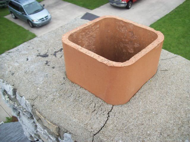

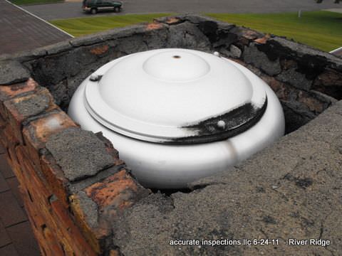

Les Posted July 7, 2011 Report Share Posted July 7, 2011 Click to Enlarge 48.64 KB Click to Enlarge 52.25 KB Click to Enlarge 34.44 KB see this most every day. We called it conspicious consumption phenomenon. Lots of brick equals wealth. Quote Link to comment Share on other sites More sharing options...
kurt Posted July 7, 2011 Report Share Posted July 7, 2011 The big chimney is just fine, no cracked cap, no lost mortar. Due to the other chimney lacking a metal liner for the combustion appliances? Quote Link to comment Share on other sites More sharing options...
John Kogel Posted July 8, 2011 Report Share Posted July 8, 2011 The big chimney is just fine, no cracked cap, no lost mortar. Due to the other chimney lacking a metal liner for the combustion appliances? No se, compadre. The bad chimney has a masonry liner and was used for the oil furnace. No longer in service. The big chimney is a fireplace, also with the original masonry liner, probably used a lot less. They've switched to electric heat, no more oil burner. Quote Link to comment Share on other sites More sharing options...
