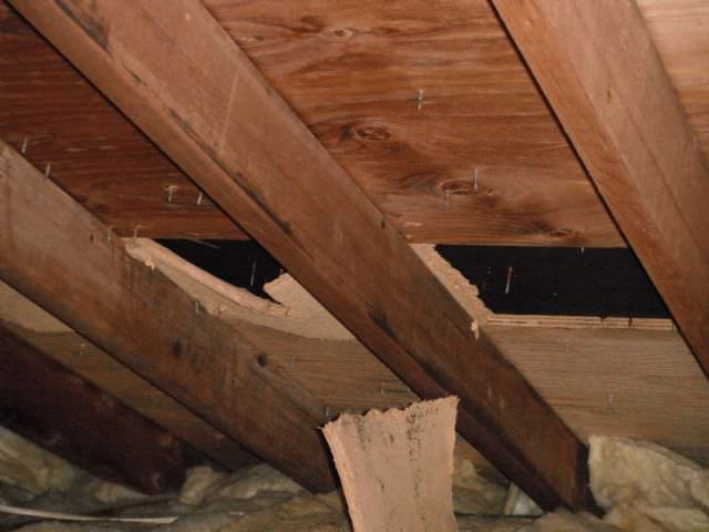

NJinspector Posted July 25, 2011 Report Share Posted July 25, 2011 I'm thinking I should start with the attic before climbing roofs now. Don't know how I didn't fall through here. Click to Enlarge 44.3 KB Quote Link to comment Share on other sites More sharing options...
ejager Posted July 25, 2011 Report Share Posted July 25, 2011 What were they thinking? Nails through tar paper are expected to hold the shingles in place? Quote Link to comment Share on other sites More sharing options...
Brandon Whitmore Posted July 25, 2011 Report Share Posted July 25, 2011 What were they thinking? Nails through tar paper are expected to hold the shingles in place? Looks like they used particle board, but it didn't work. Quote Link to comment Share on other sites More sharing options...
Jim Baird Posted July 25, 2011 Report Share Posted July 25, 2011 I'm guessing somebody had the wrong stuff to fix the hole with anyway, stepped thru it himself before covering, and, the bossman gone to the store or sleeping down in the pickup, just covered it and hoped not to get blamed later. In a real short crawlspace I found a whole lot of water pipes repaired with short pieces of gardenhose and hose clamps...handyman was the only one who knew. Quote Link to comment Share on other sites More sharing options...
John Kogel Posted July 25, 2011 Report Share Posted July 25, 2011 I wonder if the force of those long nails pushed the particle board down and the roofer goofs didn't care to check in the attic? "Watch that soft spot and let's getter done." But somebody installed that particle board and somebody covered it with roofing paper. There's no excuse for it. Jason, you should rename your pics before posting, eh? Quote Link to comment Share on other sites More sharing options...
msteger Posted July 31, 2011 Report Share Posted July 31, 2011 I'm thinking I should start with the attic before climbing roofs now. Don't know how I didn't fall through here. Click to Enlarge 44.3 KB I've always started in the attic and done the roof last for that exact reason. You never know what you'll find supporting the roof. I'd rather see it before I step on it. Quote Link to comment Share on other sites More sharing options...
