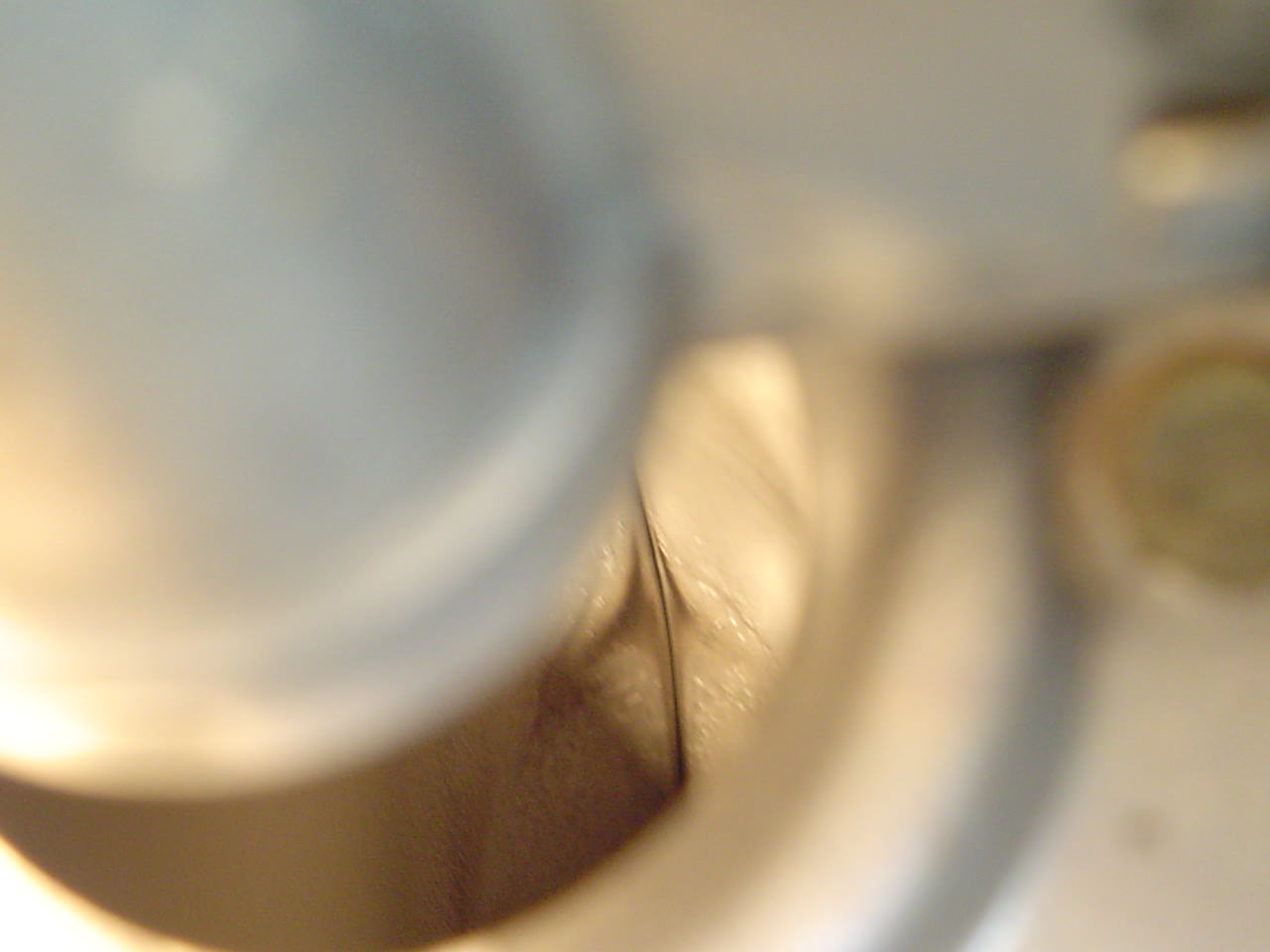

Bain Posted April 11, 2005 Report Share Posted April 11, 2005 Jim, Your photo isn't popping up. Have I stepped into this thread too late to view it? John Link to comment Share on other sites More sharing options...
Bain Posted April 11, 2005 Report Share Posted April 11, 2005 Mike, You're always so on top of t'ings. Thanks. Link to comment Share on other sites More sharing options...
Jim Katen Posted April 11, 2005 Report Share Posted April 11, 2005 Originally posted by hausdok Hi Jim Rename your photo without the parenthesis and no gaps and it'll display. OT - OF!!! Mike Sorry. I didn't realize it hadn't posted. It's fixed now. Check it out. That's from a '69 Carrier that's, I'll bet, similar to the blue Bryant that John was originally asking about. The black carbon streak is from a crack around one of the dimples. - Jim Katen, Oregon Link to comment Share on other sites More sharing options...
Bain Posted April 11, 2005 Report Share Posted April 11, 2005 Jim, Never think we don't pay attention to your sage words of wisdom. These carbon streaks were found in an eight-year-old Goodman this afternoon. Do you recommend further evaluation by an HVAC person based solely upon the streaks? I realize the photo's lousy, but getting just the right angle, and trying to make the auto-focus adjust for the inside of the burner is a trick I haven't yet mastered. John Download Attachment: DSC01089.JPG 399.02 KB Link to comment Share on other sites More sharing options...
kurt Posted April 12, 2005 Report Share Posted April 12, 2005 Hmmmmm......there's a certain pornographic element to that photo. Sure evidence that all those suckers are cracked. When one starts dismantling furnaces, it's spooky how many have cracks. Link to comment Share on other sites More sharing options...
Bain Posted April 12, 2005 Report Share Posted April 12, 2005 Now that you mention it . . . Kurt, are you saying the carbon is sure evidence the Goodman is toast? Link to comment Share on other sites More sharing options...

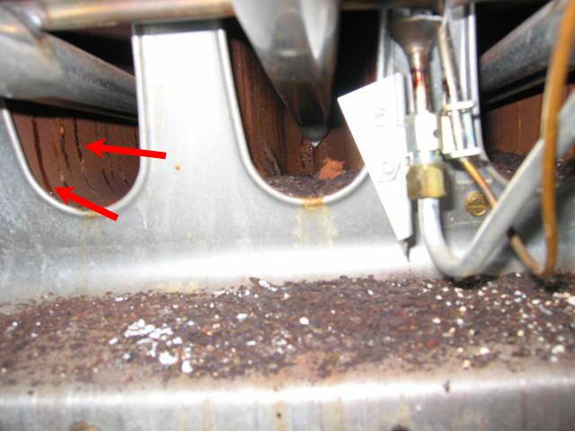

DonTx Posted April 12, 2005 Report Share Posted April 12, 2005 LMAO, Kurt, that's exactly what I thought when I saw that pic. Now, back to business..lol What are these streaks (red arrows) on this furnace? I'm assuming they are moisture related. Have never got the chance to tear apart a heat xchanger...yet. Download Attachment: IMG_1878.jpg 60.33 KB Link to comment Share on other sites More sharing options...
Jim Katen Posted April 12, 2005 Report Share Posted April 12, 2005 Originally posted by Bain Jim, Never think we don't pay attention to your sage words of wisdom. These carbon streaks were found in an eight-year-old Goodman this afternoon. Do you recommend further evaluation by an HVAC person based solely upon the streaks? Actually, I think Mitenbuler's the wise one. I'm more of a wiseass. If I thought that the streaks were caused by a separation at that seam, I wouldn't recommend further evaluation, I'd just recommend replacing the furnace. However, my hunch is that we're just seeing a cool spot on the exchanger in your picture. That seam's in an easy enough spot to see when the furnace is firing. I'd fire it up and watch the flame when it gets near that seam. If it's leaking air, then the flame will distort, or at least discolor, at that point. Personally, I never recommend further evaluation of furnaces unless I have something very specific in mind. For instance, "Hire an HVAC tech to cut open the back of the furnace to rule out the possibility of cracks in the heat exchanger." I realize the photo's lousy, but getting just the right angle, and trying to make the auto-focus adjust for the inside of the burner is a trick I haven't yet mastered. John I don't recommend this to anyone else, but I'm not above pulling a burner now & then to get a better view. I must stress, however, that I DO NOT recommend that you do this. (But it sure makes it easy to get fine pictures of why a furnace should go away.) - Jim Katen, Oregon Link to comment Share on other sites More sharing options...
MechAcc Posted May 2, 2005 Report Share Posted May 2, 2005 Originally posted by Donald Lawson LMAO, Kurt, that's exactly what I thought when I saw that pic. Now, back to business..lol What are these streaks (red arrows) on this furnace? I'm assuming they are moisture related. Have never got the chance to tear apart a heat xchanger...yet. Download Attachment: IMG_1878.jpg 60.33 KB This looks like a Comfortmaker the areas where the cells crimp to the vestibule panel at the burner area and at the draft hood leak. The folded seams where the two shells are joined together may also leak and if you look up through the draft hood you may find holes rusted through the top of the cell. Link to comment Share on other sites More sharing options...
