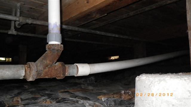

Robert Jones Posted February 29, 2012 Report Share Posted February 29, 2012 53 year old home that has obviously had some "updating". In this pic you see the washing machine drain line coming down to a "t". The run to the right goes horizontally along the crawl space floor and terminates outside the home with a "cleanout" at the top. The run to the left of the "t" goes into the drain system. Any idea what they were thinking with this setup? IF it's the stack vent, it's obviously wrong, but what else could it be? Click to Enlarge 29.63 KB Click to Enlarge 41.09 KB Link to comment Share on other sites More sharing options...
Bain Posted February 29, 2012 Report Share Posted February 29, 2012 I think you nailed it, but one has to wonder why the galvanized "vent" to the right had to be replaced with PVC. Maybe the drain to the left was the original vent, and the tee was reversed because someone grew tired of the clothes washer dumping water into the backyard. Link to comment Share on other sites More sharing options...
Jim Katen Posted February 29, 2012 Report Share Posted February 29, 2012 53 year old home that has obviously had some "updating". In this pic you see the washing machine drain line coming down to a "t". The run to the right goes horizontally along the crawl space floor and terminates outside the home with a "cleanout" at the top. The run to the left of the "t" goes into the drain system. Any idea what they were thinking with this setup? IF it's the stack vent, it's obviously wrong, but what else could it be? Perhaps this drain clogs up frequently and they got tired of dragging the snake into the crawlspace. Link to comment Share on other sites More sharing options...
allseason Posted March 1, 2012 Report Share Posted March 1, 2012 Where's the trap? Link to comment Share on other sites More sharing options...
Jim Katen Posted March 1, 2012 Report Share Posted March 1, 2012 Where's the trap? If it serves a washer, the trap will be above the floor, at the standpipe. Link to comment Share on other sites More sharing options...
